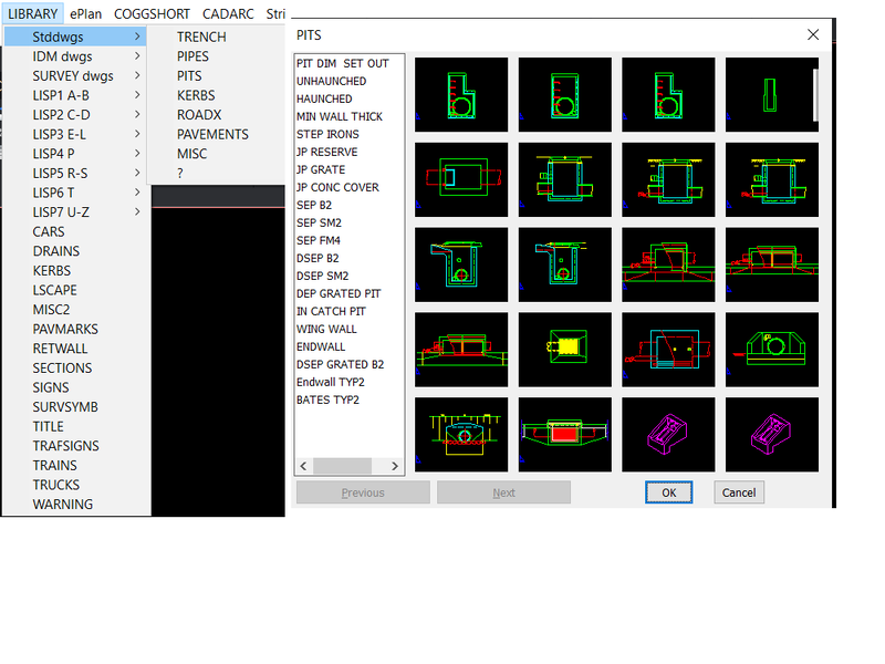

  5. Look at this pop menu. You can see the block sub sections in the menu. Nice thing about POP image menus is that you can have more than 20 blocks so next and previous works.
    1 point
