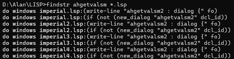

  4. Findstring may be your friend, its a window cmd you type cmd down left to go to command mode of windows. I have a bat file setup so type "fnd Ahgetvalsm" it goes to my lisp directory then runs this command. Findstring ahgetvalssm *.lsp It looks through all my lsp files for a match so in your case look into *.dcl for a dialog name if it comes up with two then you have a problem. Yes no quick way to get each dialog name. As suggested by @Steven P you could open every file lsp & dcl and reading a line at a time, look for "dialog" and save that line file name to a list when found. I guess then can run bat files from lisp so use Findstring.
    1 point
