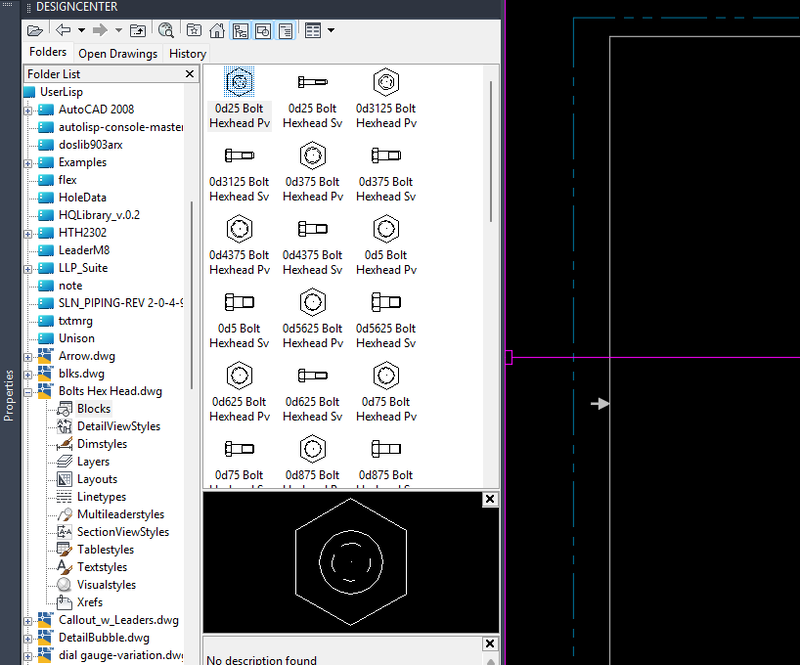

  2. @jim78b Have you tried the Autodesk Design Center? You can drill into drawings and pull out blocks, layers, etc.. You can use a short program to pull up design center in the folder you want - something like: ;;-------------------------------------------------------- ;; Command: (C:DSN) ;; Description: ;; This Command Starts the AutoCAD Design Center window ;; in the path specified. ;;-------------------------------------------------------- (defun c:DSN ( / usrpath) (setq usrpath "C:\\MyBlocks");<--CHANGE TO YOUR PREFFERED LOCATION. (if (= (getvar "adcstate") 0) (if usrpath (command "._adcnavigate" usrpath)) (command "._adcclose") ) (princ) ) ;; End Command "DSN"
