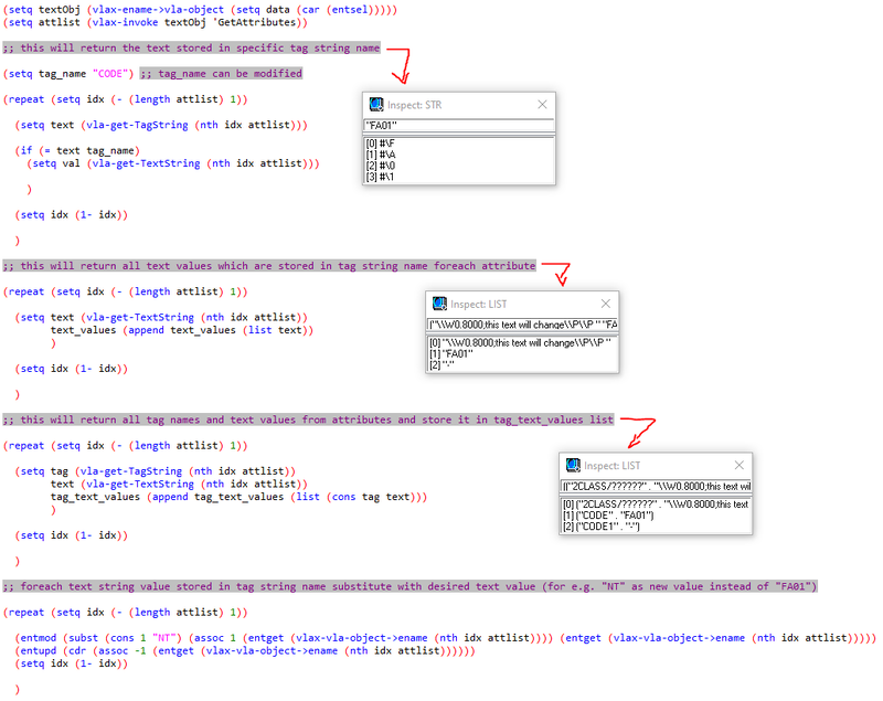

  4. Hi @p7q, You can try with this several options from image below. From the last lines of code, you will get something like this. Try to play with this. Also, you can get from Lee Mac website about Attribute Functions. Best regards.
