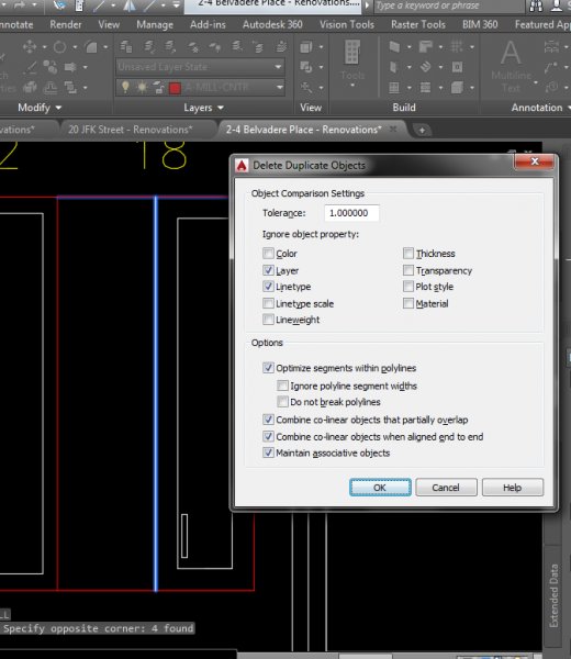

Tried this option on ignore all object properties. Increased fuzziness to 10. Ticked and unticked "Optimize segments within polylines, Combine co-linear objects that partially overlap and end to end". It still doesn't produce 3 lines that I expect. Am I expecting something wrong here? The overkill operation seems particularly bad at deleting lines that are completely covered by another line and sometimes wouldn't even work with lines that have the same end point. overkill.dwg

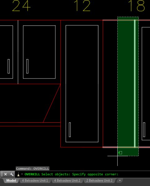

usually it works like a charm but sometimes it plain does nothing. like in this example, there are two overlapping white lines. I do the overkill command and set a high tolerance, but it doesn't do anything. See pictures. why does it work sometimes and then other times it completely does nothing?
