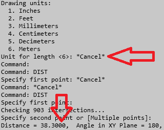

Ric Posted November 14, 2011 Share Posted November 14, 2011 Has anyone had any success with this solution? I have not. http://usa.autodesk.com/adsk/servlet/ps/dl/item?siteID=123112&id=13717811&linkID=9240617 What happens when I open an infected folder is the following loop until I hit Esc and cancel it. The virus remains. Any suggestions? Quote Link to comment Share on other sites More sharing options...

Ric Posted November 14, 2011 Share Posted November 14, 2011 I tried what was recommended but I replaced logo.gif with acad.fas since that is one we are having a problem with. See attached. I have an acad2009.lsp file in both C:\Program Files\AutoCAD 2009\Support and in C:\Users\ric\AppData\Roaming\Autodesk\ACD-A 2009\enu\support so I added the code to both files Quote Link to comment Share on other sites More sharing options...
