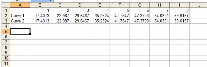

I have a curve and I need a quick way to make linear dimensions to one axis that I've customly drawn say - x for example - to get the distance coords of the curve's points to this custom axis that i make so this axis is basicly arbitrary line.. I can't do this by hand because they are so many..
Other way to approach is - I have a net with intersections of x's and y's of curve and need to draw the linear dimension from intersections to one arbitrary line..
Also is good to get the coords in table or file so i can get it quick to excel for other calculations...
If someone can help me..
Thanks!

sinmania
WOw:?. It works perfectly! Exactly what i need for first task. Thanks!
The problem with intersections still remains... To get the distance from intersections of spline with choosed lines to one axis...
Here is my new need - I hope that I'm very insolent.:oops:
distance2.dwg
Link to post
Lee Mac
My function already copes with this.
Can't you just select the curve and specify the measurement interval to be the distance between your lines.

sinmania
I've tried by it gets the measurement interval from the curve not from the line that i use for axis. And measures the distance in equal spaces of the curve not of the line. So where the curve bends it calculate the length also and the points are shifting.
Also there are places that i've need more datail so I will make more intersections and they will be not in equal spaces ... If there is an option to choose lines which intersect and find the distance of intersections of curve to new specific orgin.
But still if the measurement interval works for choosed equal line intervals not equal curve intervals it will make my life easier I will do by hand other intersections that are not equal..
distance3.dwg

Lee Mac
Give this a shot:

Lee Mac
Just the output is little bit odd in 2 cells not every new value in new cell... also there are no y values registered in csv file only number of frame and x...
The output seems to be fine to me? - I know there is no y-value, but I thought you only wanted x values?
See pic attached for how mine appears in csv.
