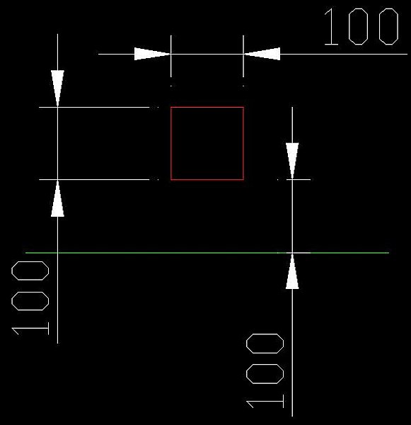

Strange thing is: when i open a clean new drawing an i try the command it sometimes draws "not okay". I mean, it looks like there is a variable not calculated right. That cannot be for it works sometimes.
See the images, can you place this? The left is gooed, the right image shows the #$%@ up one.
I thought it might have something to do with the _.pline function so I took a rectangle to do the job.
Now it stays "in shap" but the dimension is not correct. ie. I create a box 1500 x 200 dist 100...
I get a box 1423 x 261 dist 100.
This will be the OSnaps coming into play when you use the "_.pline" command.
You will need to turn them off and back on again to make this routine consistent.
This will help you in turning off the OSNAPs, but if you want complete "security" in this routine, you will need to add an Error Handler to switch the OSNAPs back on if the user hits Esc.

A quick question "on topic"... imagine i want to _.pline from pt3 to pt4 etc. When the pline command ends I would like to draw a circle, lets say on pt3 with a diameter dia1.
So first i will prompt for diameter, somewhere in the routine, kinda like this:
(setq dia1 (getint "\nDiameter of cicle"))
When command pline ends I would like to draw the circle:
(command "circle" pt3 "d" dia1)
So lets melt it together:
(defun c:box1  (/ oldos len leng dist pt1 pt2 pt3 pt4 pt5 pt6)
 (setq oldos (getvar "OSMODE")  ; Collect Old OSMODE setting

I had to modify it so the box is rotated more natural (at least to me it is), the direction is the direction of wich the crosshair is moved. It is nothing difficult for those who get it, to me it was quite sweaty but I managed to do so:
(defun c:[color="Red"]box99[/color]  (/ oldos len leng dist pt1 pt2 pt3 pt4 pt5 pt6)

So this one I like better. Next thing I want to do is that the second time I invoke box99 it must "propose" the length / with / dist as given the first time.
I guess it has to do with initget and keyword, read about it but did not play with it. So thats one of my challenges to come. One of many I am afraid.
