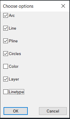

As this is a complete upgrade to the program in the recent thread of the same topic, I thought I'd include it in a new thread so that it can be found easier with searches etc.
Let me know if you find any bugs etc - or any suggestions you may have.
I tried to keep it as general as possible so that the majority of users could get something out of it. But if you want it customised to meet your particular needs, I'd be happy to lend a hand.
Type: LenCal to invoke ~ if the Dialog doesn't load first time, just re-invoke the command.
All code can be found here.

Lee Mac
Steve, I have updated the code in the first post to a new version, give it a shot and see if that does the trick - after all, we need this thing to be accurate :P

I also added a wcmatch string edit box, so that the user can manually filter results within each section - useful for when you have hundreds of layers.
i.e. to list all layers beginning with "t" type t*
To find all layers with numerical names, type #
Just read up on the wcmatch function to know all the different search characters. :)
etc etc

I have updated the first post with Version 4.
Let me know if there are any issues with it :wink:

Lee Mac
i can find no issues right off the bat:D
Thats always good o:)
I have included an extra filter: colour.
If you have any ideas for other filters you might want, let me know - the hardest part with making any of these programs is having the ideas... :wink:
