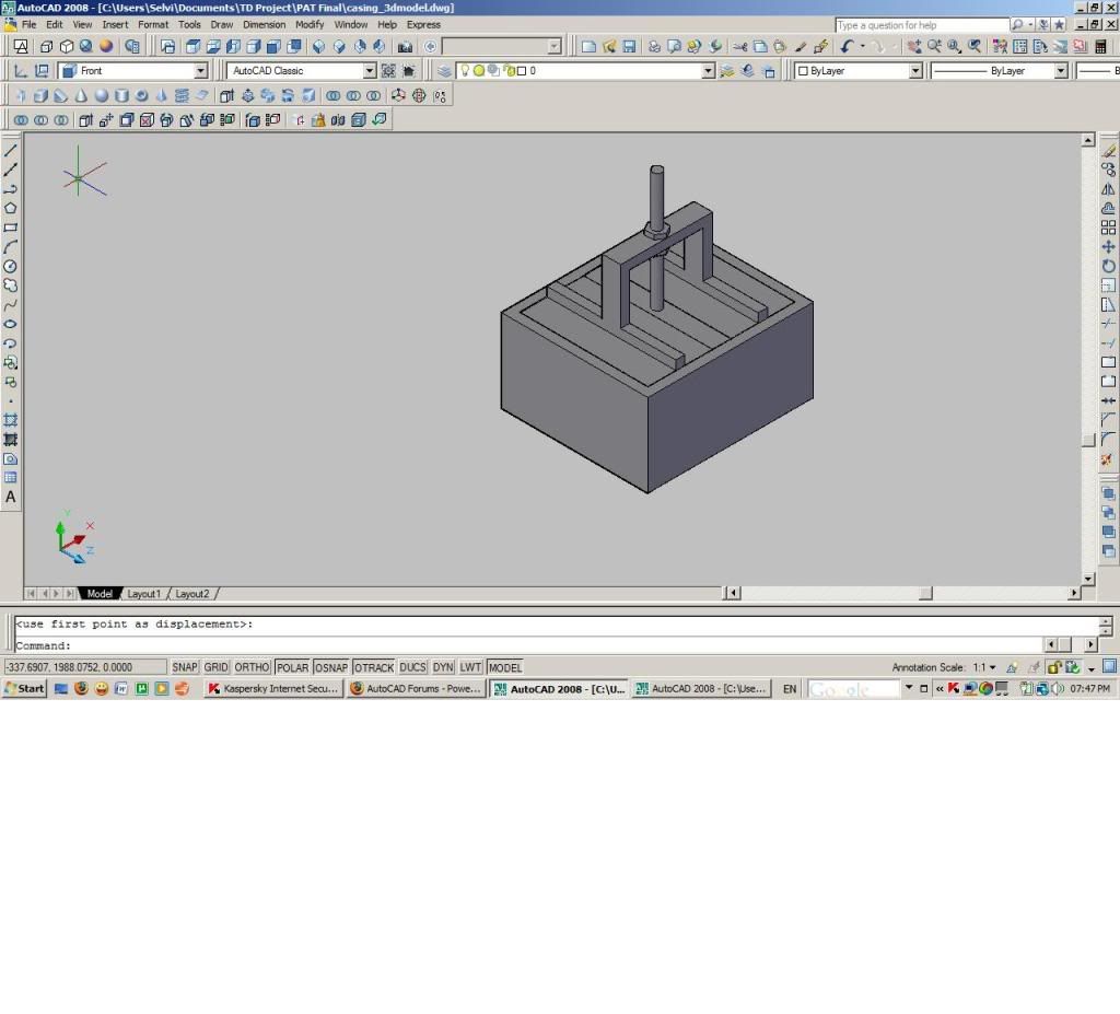

grandmaster87 Posted July 19, 2009 Author Share Posted July 19, 2009 anyway i did not add the threads , as i found out the school doesnt require us to insert threads:) thats the finished product...all i need to do is add an extension onto the end of the bolt/slash handle. basically like a tap , as i turn the handle the plate will move downwards , hence pressing down on the liquids. at the bottom is drainage holes , and the liquid will go there... what you guys think? any design flaws? if you want to see the cad files let me know and i will email it to you.. its more than the allowed upload size. Quote Link to comment Share on other sites More sharing options...
deres Posted July 19, 2009 Share Posted July 19, 2009 how do i make a line 45 degrees or 10 degrees etc? what command can i use? Sorry grandmaster87, I was busy for a while. To make a line 45 or 10 degrees, simply draw a line at any direction, select and rotate it by typing the required degrees. Experiment a bit with the degrees, you can have minus numbers too, -60, -30 etc. Your final product looks real good, add a human-friendly handle and it's perfect! I'm glad I helped Quote Link to comment Share on other sites More sharing options...
grandmaster87 Posted July 19, 2009 Author Share Posted July 19, 2009 no problem man.. do you have any suggestions for a human-friendly handle? Thank you alot for the 3d model of the base...it really helped me alot and i couldnt have done it without you!! for that i am thankful. Quote Link to comment Share on other sites More sharing options...
deres Posted July 19, 2009 Share Posted July 19, 2009 A device like that needs much effort...I would use a metallic tube with wooden or plastic grips at both edges for the hands... Quote Link to comment Share on other sites More sharing options...
grandmaster87 Posted July 19, 2009 Author Share Posted July 19, 2009 thank you , i will get to work on that tomorrow. right now i need to go to sleep. school starts tomorrow after a 3 week break. Now that i have the 3d-model , all i need to do is a front sectioned view , top view and either left or right view. Thanks for all your help and to everyone who contributed , Deres , cAD64 and Cadmaster Quote Link to comment Share on other sites More sharing options...

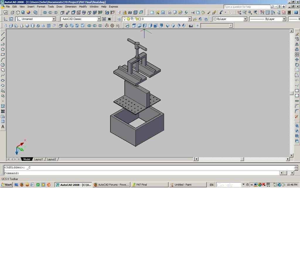

grandmaster87 Posted July 21, 2009 Author Share Posted July 21, 2009 Here is a screeny of what it all looks like... Quote Link to comment Share on other sites More sharing options...
ReMark Posted July 21, 2009 Share Posted July 21, 2009 You can use bar stock to form the handles. Cover them with wood (two halves) secured through the bar stock with the appropriate type of screw/washer and matching nut. Quote Link to comment Share on other sites More sharing options...
