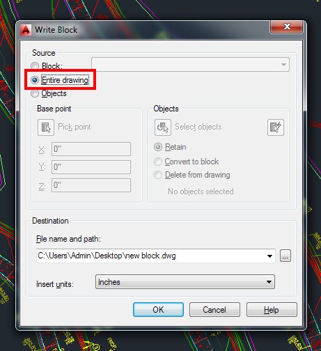

Just run the WBLOCK command.
Make sure you're in Model Space and your UCS is set to World. Then run WBLOCK and choose the "Entire Drawing" option.
I get troublesome drawings sent to me all the time and running WBLOCK strips out all the garbage and gives me a nice clean file to work with.

One thing you have to realize is that after you run WBLOCK and generate a new clean file, if you copy anything from another problematic drawing and paste it into your new file, you have now infected your clean file with all the same junk again.
Try running WBLOCK on both files. Then do the copy and paste and see if you still have issues.
