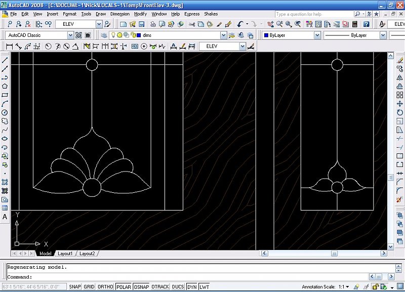

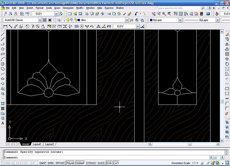

nicnicman Posted May 7, 2008 Share Posted May 7, 2008 Recently I created an elevation which included a door with leaded glass. When I originally drew the arcs and circles they were symmetrical and smooth, but now they are rough and ugly. (See attachment) What happened? TIA Nick Quote Link to comment Share on other sites More sharing options...
khama Posted May 7, 2008 Share Posted May 7, 2008 Try maybe setting the facets to a higher level. type: facetres into your command line and set it to 10. If you were zoomed out a long way from the object and zoomed into the location, type alt+V+A (hold down alt and type V+A). This will instantly refresh the facets. If that does not work then I am afraid that 2008 is not known to me yet. Everyday is a learning curve towards knowledge.... Quote Link to comment Share on other sites More sharing options...
PS_Port Posted May 7, 2008 Share Posted May 7, 2008 Try REGEN, also look at VIEWRES (higher the better) Quote Link to comment Share on other sites More sharing options...
PS_Port Posted May 7, 2008 Share Posted May 7, 2008 khama, I thought facetres only effects 3D ?? I could be wrong:unsure: Quote Link to comment Share on other sites More sharing options...
nicnicman Posted May 7, 2008 Author Share Posted May 7, 2008 I tried all the solutions separately and they all worked. Thanks a lot! Quote Link to comment Share on other sites More sharing options...
khama Posted May 7, 2008 Share Posted May 7, 2008 khama, I thought facetres only effects 3D ?? I could be wrong:unsure: I covered all my bases... Quote Link to comment Share on other sites More sharing options...
nicnicman Posted May 7, 2008 Author Share Posted May 7, 2008 Heres the new image. Quote Link to comment Share on other sites More sharing options...
PS_Port Posted May 7, 2008 Share Posted May 7, 2008 very nice nic, now what about some nice colours for the glass.. Quote Link to comment Share on other sites More sharing options...
nicnicman Posted May 7, 2008 Author Share Posted May 7, 2008 Just tried setting the facetres to 10 and it didn't work. I didn't try this one before. Although I did try Alt V+A and it worked. By the way I like the color effects. Quote Link to comment Share on other sites More sharing options...
khama Posted May 8, 2008 Share Posted May 8, 2008 Just tried setting the facetres to 10 and it didn't work. I didn't try this one before. Although I did try Alt V+A and it worked. By the way I like the color effects. Facetres basically selects the number of facets in the objects geometry. This setting is variable and maybe 10 facets per object is too intense for the intricate shapes that you have. This setting can be ranged between 0.5 - 10. I say 10 because if I go any higher than that it does not work for me. Try setting it to 8 and keep reducing it from there until it does work. You just have to find the limits manually I suppose. Unless someone else knows a better way?? Quote Link to comment Share on other sites More sharing options...
AVITWeb Posted May 9, 2008 Share Posted May 9, 2008 Facetres basically selects the number of facets in the objects geometry. This setting is variable and maybe 10 facets per object is too intense for the intricate shapes that you have. This setting can be ranged between 0.5 - 10. I say 10 because if I go any higher than that it does not work for me. Try setting it to 8 and keep reducing it from there until it does work. You just have to find the limits manually I suppose. Unless someone else knows a better way?? Also try WHIPARC Quote Link to comment Share on other sites More sharing options...
