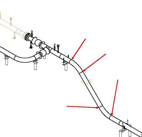

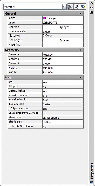

N_461 Posted August 19, 2009 Posted August 19, 2009 I've attached a jpg of what i'm talking about. We're using CADWORX Piping suite and can't (or at least i cant) draw a 45deg S-Bend riser. Used bent command in cadworx and this is what i get. ALSO, using a sweep i still get the same results, just with no smarts to the object. no biggie. HOW do i display this so that the noted lines do not appear????? I set: isoline = 0 facetres = 0.5 (default) in options, display, contour lines per surface = 0 I have also attached my VP Properties dialog box for your viewing pleasure. hopefully this is enough information. I tried searching but am running out of time...THANKS! Quote
ReMark Posted August 19, 2009 Posted August 19, 2009 Don't those lines appear because the objects in question are separate entities? You didn't union everything together did you? I don't know if I would refer to them as tesselation lines. That brings something else to mind for me. Maybe I'm mistaken. It's that whole terminology thing. Quote
Guest Posted August 19, 2009 Posted August 19, 2009 To my knowledge there is not a way to remove thoes linse aside from using SOLDRAW/SOLVIEW. It is only a line representing the transition from curve to curve. Quote
N_461 Posted August 19, 2009 Author Posted August 19, 2009 In response to ReMark: Sorry about the terminology, just didnt know how to describe them. This is one piece of pipe and to answer the second reply, in my mind they do simply rep the transition. I am waiting to explain this to our Eng but he's away or in meetings or away. In response to Secretagdan: i thought about solview and draw etc.. but actually never tried it come to think of it...i'll check that out and get back... Quote
N_461 Posted August 19, 2009 Author Posted August 19, 2009 yah, i ran solview but that essential does the same as flatshot or 2dREP...2d rep seems to be doing the job but there must be some other way... Quote
Guest Posted August 19, 2009 Posted August 19, 2009 I have also looked for another solution to this, but have come up with nothing. If there is a solution to this, it would make my boss happy I am sure. Quote
SuperCAD Posted August 20, 2009 Posted August 20, 2009 Those are tangent lines. If you view your drawing in "conceptual" or "realistic" you can turn those off by changing your Edge Mode to NONE (VSEDGES system variable). The only way I can think of to hide/delete them is to FLATSHOT your view (and delete them if they show up in the block). Quote

N_461 Posted August 20, 2009 Author Posted August 20, 2009 Those are tangent lines. If you view your drawing in "conceptual" or "realistic" you can turn those off by changing your Edge Mode to NONE (VSEDGES system variable). The only way I can think of to hide/delete them is to FLATSHOT your view (and delete them if they show up in the block). Ok, so i set my VSEDGES to 0 but will only work if the VSFACESTYLE is set at 1 or 2. I usually plot of to HIDDEN because we work with B&W hard copies on 11x17. Is theere a way to set the colour of the style to the background colour so they would be displayed as if on the HIDDEN shade plot? make sense? I need it to plot off with a Hidden shade plot, but I need the Viewport to just display the 2d wireframe (not the best computers). For now I'm leaving it and am going to adivise my P.Man that thats how it is. Otherwise we have to either flatshot or 2d rep things into layout. I played around with the Visual Style tab on the ribbon palette but nothing seems to work....unless i plot as a semi-rendered 3d model (Gooch or realistic) I need an Easy Button... Quote

SuperCAD Posted August 20, 2009 Posted August 20, 2009 If he's just looking for a pretty picture to show his clients, then just FLATSHOT the 3D model. The tangent lines won't appear (or if they do, at least you can delete them). Quote
N_461 Posted August 20, 2009 Author Posted August 20, 2009 If he's just looking for a pretty picture to show his clients, then just FLATSHOT the 3D model. The tangent lines won't appear (or if they do, at least you can delete them). Aren't we all? HAha. Yah my backup plan is to 2dREP the model (or flatshot) and erase the lines. Whatever our pool is more comfortable with doing. Quote
OLD SCHOOL Posted August 28, 2009 Posted August 28, 2009 In my experience with cadworx and acad, there is no way to hide those, as although it is one piece of pipe, the software still builds it up using solid individual objects. You can try create the pipe out of solids and manipulate the colour of the faces under "solids editing" to make them plot lighter. Keep the cadworx centre line in place for your MTO. Not sure?? Quote

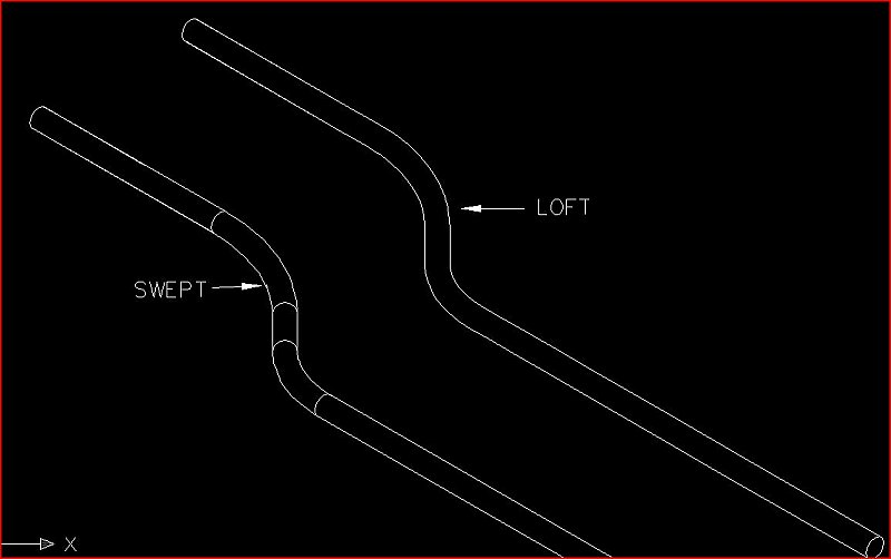

dumfatnhappy Posted August 28, 2009 Posted August 28, 2009 interesting thread. I messed around and after doing a hide command got this; Quote
N_461 Posted August 28, 2009 Author Posted August 28, 2009 i've never used loft before, i'll give it a whirl. hopefully it works in our application..... Quote
