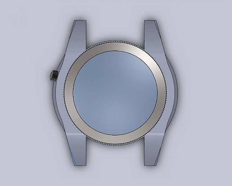

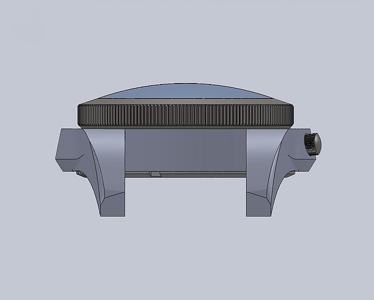

lulumara Posted September 27, 2009 Author Share Posted September 27, 2009 Hi Matt thanks for all the helped you advised me, it's really helped me finished it. To cut the triangle I did drawn a 3 lines in front , side of the lug and top (use project curve ) then used fill surface command, trim surface or cut thicken any of the two commands. Many thanks again I just posted it so anyone who who encounter this problem can see the solution . Quote Link to comment Share on other sites More sharing options...
lulumara Posted September 27, 2009 Author Share Posted September 27, 2009 Here's the final result Quote Link to comment Share on other sites More sharing options...
lulumara Posted September 27, 2009 Author Share Posted September 27, 2009 Sorry this is the final one got some adjustment: Quote Link to comment Share on other sites More sharing options...

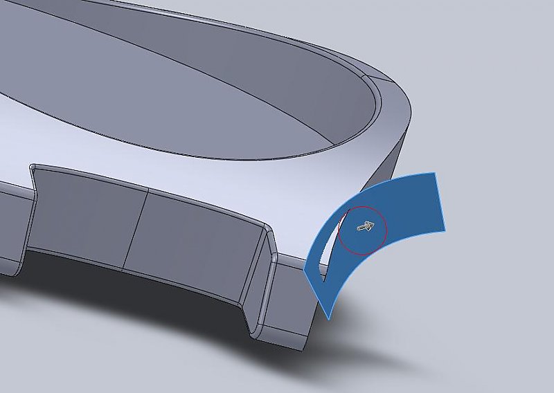

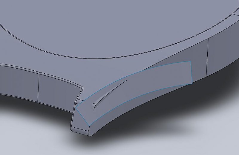

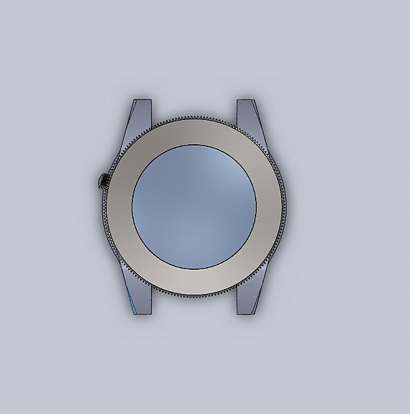

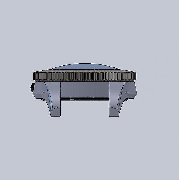

shift1313 Posted September 28, 2009 Share Posted September 28, 2009 very nice. This morning i took some screen shots of the swept surface/cut with surface procedure although it appears to be too late:) The first image shows the surface going through the part. First thing i did was create the straight line on a plane created away from the part(edit, i could have created a 2d sketch on the surface of the part as well). Second I created a 3d sketch spline which can be seen in pic 5 where i go back to edit it. Picture 2 shows the cut with surface operation. Notice the arrow i circled. This is the direction of the base solid that will be removed. Once the cut was made, i went back to my sketches and edited them to get more "cut". Once you exit the sketch the surface and cut should update automatically. Quote Link to comment Share on other sites More sharing options...
lulumara Posted September 28, 2009 Author Share Posted September 28, 2009 Great another suggestions I did drawn it infront or plane -face of lugs then top view used curve /project curve to the face of lugs and drawn in side of the lug used the fill surface and trim surface or cut thicken . Many thanks Matt !! Quote Link to comment Share on other sites More sharing options...
