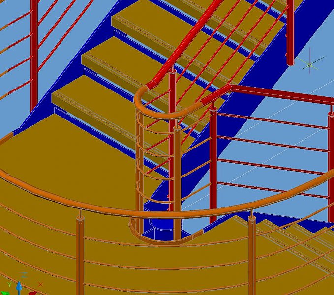

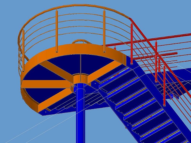

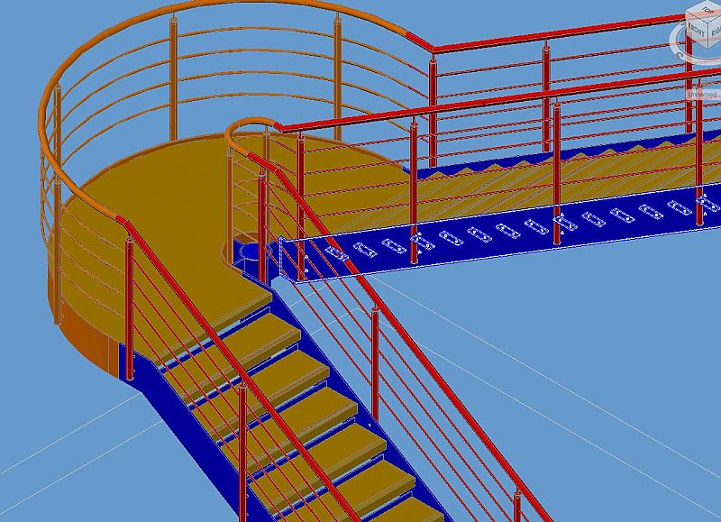

CADMASTER1128 Posted October 5, 2009 Posted October 5, 2009 Another couple of views. Looks like a stair case I saw on my cruise!! LOL Quote
ReMark Posted October 5, 2009 Posted October 5, 2009 One way you can do it is to use a 3Dpolyline and then Sweep the profile of your rail along it. The rail profile will follow the 3Dpoly even if there is a 90 deg turn (not radiused) and at an angle too. Quote
