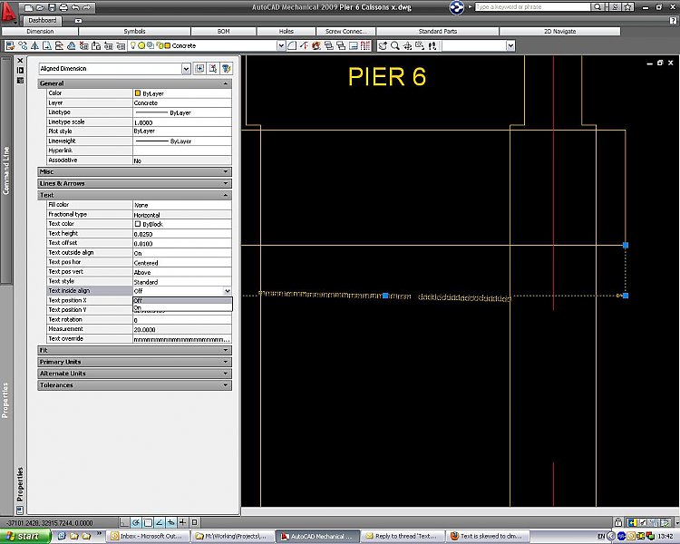

GE13579 Posted October 20, 2009 Share Posted October 20, 2009 Hmmm looking more into it by turning off 'Text inside align' seems to replicate the problem... Quote Link to comment Share on other sites More sharing options...

GE13579 Posted October 20, 2009 Share Posted October 20, 2009 Hmmm DIMTIH doesn't seem to work either? Quote Link to comment Share on other sites More sharing options...
lenmac Posted October 20, 2009 Author Share Posted October 20, 2009 GE13579: I can't figure out how you got this to plot correctly to a pdf file(???) At first, I thought perhaps it might be as simple as a bad printer driver. However, I tried to print it to a pdf creator and got the same result - looks fine in the Layout but skewed text in the Full Preview and the Plot. I tried turning off the "text inside align" and this skewed the text even in Model space, even though the UCS was set to World. The mystery deepens.... Quote Link to comment Share on other sites More sharing options...
GE13579 Posted October 20, 2009 Share Posted October 20, 2009 All I can think is it must be something to do with local settings (?). Is the problem the same with any drawing? BTW I needed Text inside align turned on- when I turned it off it skewed. Quote Link to comment Share on other sites More sharing options...
