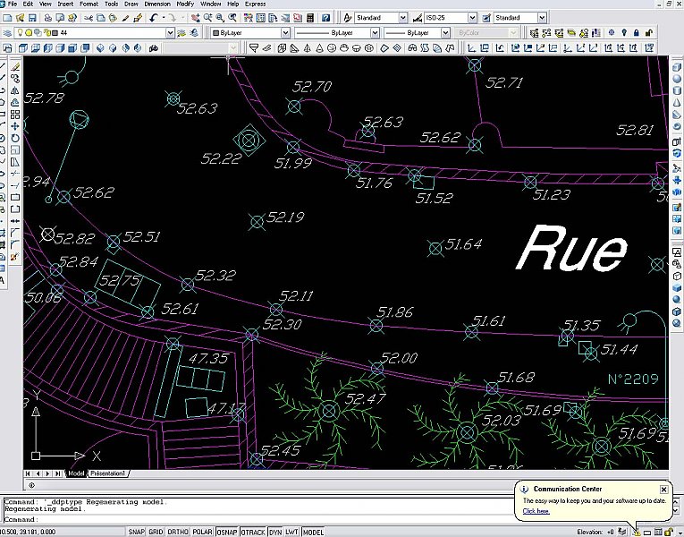

eldiego18 Posted October 27, 2009 Share Posted October 27, 2009 I have this survey 2d .dwg file and there are lots of points with hights writen next to them, anybody know an easy way to create a 3d terrain out of that, or contour lines maybe? im a user of autocad, but im trying civil 2010 but im new on it. here im attaching an image of the file so you can have a better idea of what im talking about. i think the points are just blocks, if anyone can help would be much apreciate it. Quote Link to comment Share on other sites More sharing options...

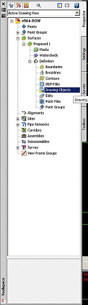

alanjt Posted October 27, 2009 Share Posted October 27, 2009 Create a surface, then add Drawing Objects. Quote Link to comment Share on other sites More sharing options...
CarlB Posted October 27, 2009 Share Posted October 27, 2009 If you are using plain AutoCAD, no easy way (built-in) to create a surface or contours. Alanjt is using Civil 3D it appears. -Do you really need a surface/contours? Looks pretty flat, other than the stairs. -you could calculate contours manually. -you coud use free program, "site topo". It will be a bit of work to select points for inclusion, create breaklines, etc. But better than manual. Quote Link to comment Share on other sites More sharing options...

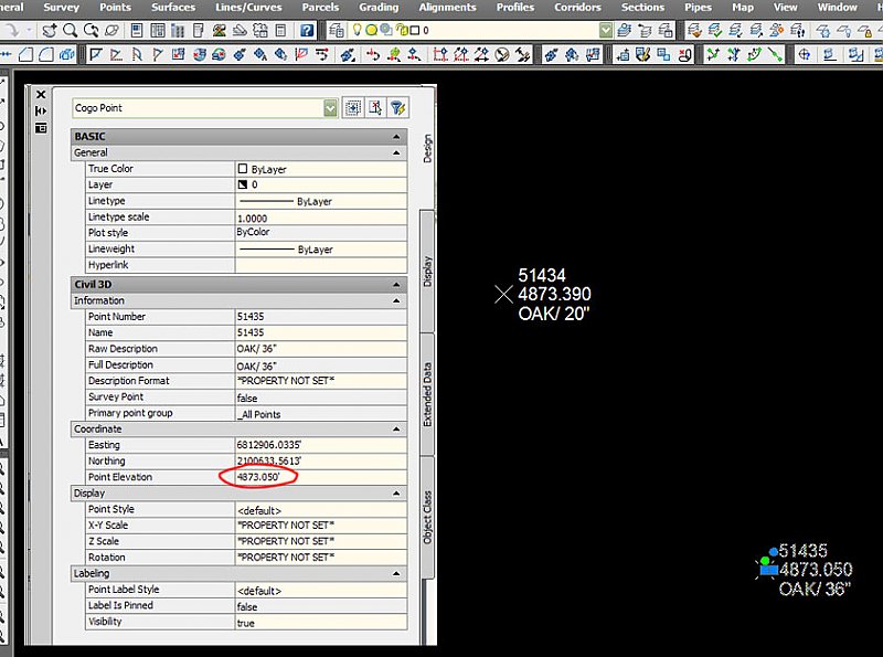

ScribbleJ Posted October 27, 2009 Share Posted October 27, 2009 If the points do not have an actual Z value to them then your not going to be able to use them to create a surface. Quote Link to comment Share on other sites More sharing options...
alanjt Posted October 27, 2009 Share Posted October 27, 2009 If the points do not have an actual Z value to them then your not going to be able to use them to create a surface. Very true. Post an example. Civil 3D will also convert a lot of objects to points. Quote Link to comment Share on other sites More sharing options...
ScribbleJ Posted October 27, 2009 Share Posted October 27, 2009 Example as requested. Notice the elevation encompassed in red. That would be an actual Z value. If it said 0.00 then you would have a Z value that cannot be used to create a surface with. Likewise, if blocks have a Z value in the properties of 0 the same would be true. Quote Link to comment Share on other sites More sharing options...
alanjt Posted October 27, 2009 Share Posted October 27, 2009 Example as requested. Notice the elevation encompassed in red. That would be an actual Z value. If it said 0.00 then you would have a Z value that cannot be used to create a surface with. Likewise, if blocks have a Z value in the properties of 0 the same would be true. Oops, I meant for eldiego18 to post an example. I know what c3d points are like. Quote Link to comment Share on other sites More sharing options...

Strix Posted October 28, 2009 Share Posted October 28, 2009 where did the drawing originally come from? was it originally produced on survey software and has it been FLATTENED in AutoCAD? Before spending a lot of time trying to make it useable for your needs, I'd check there isn't a 3D version available somewhere! Quote Link to comment Share on other sites More sharing options...
eldiego18 Posted October 28, 2009 Author Share Posted October 28, 2009 thanks guys, yeah i know about points in civil 3d, just figured it would be an easy way to convert those 2d points from autocad to points in civil3d (with a z value) i zoomed in my image so you guys see the points the actuall full terrain is a lot more abrupt. any other simple ideas ( even not including civil 3d? what i need finally is a 3d terrain but a surface/mesh or contour lines would do) Quote Link to comment Share on other sites More sharing options...
eldiego18 Posted October 28, 2009 Author Share Posted October 28, 2009 Strix i got the drawing from a survey enginer but it was flattened already. im sure they have it but it would mean i have to pay... Quote Link to comment Share on other sites More sharing options...
eldon Posted October 28, 2009 Share Posted October 28, 2009 Looking at the drawing, I would say that it has never been drawn in 3D. The curves are too sweet! The only way to make it into a 3D model is by hard work helped by a lisp routine or two to help with the repetitive jobs I don't know of any short cuts for turning a 2D survey drawing into a 3D ground model, using only the information in the drawing. Quote Link to comment Share on other sites More sharing options...
alanjt Posted October 28, 2009 Share Posted October 28, 2009 Once again, POST AN EXAMPLE and we can figure something out. Block out a few points and upload a dwg. Quote Link to comment Share on other sites More sharing options...
