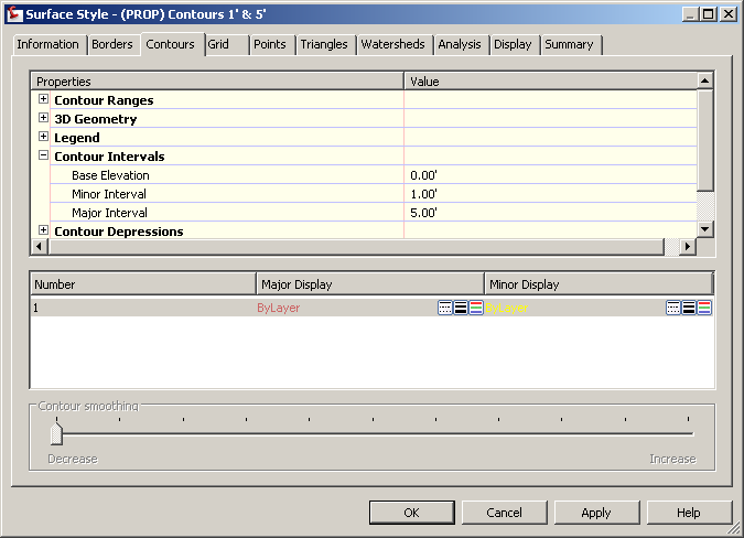

eldiego18 Posted October 29, 2009 Author Share Posted October 29, 2009 what about if i wanna add more contourlines, like lest say one each .5m Quote Link to comment Share on other sites More sharing options...

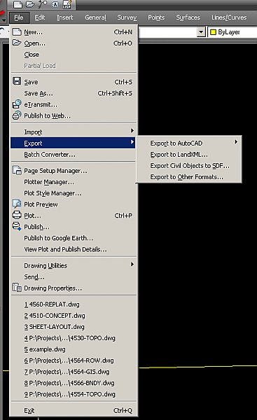

eldiego18 Posted October 29, 2009 Author Share Posted October 29, 2009 awsome! you've been such a great help, now last thing so i dont bother you no more how do i export this to an earlier vertion of regular cad or to any other extension so i can work on my 3dmodel Quote Link to comment Share on other sites More sharing options...
alanjt Posted October 29, 2009 Share Posted October 29, 2009 what about if i wanna add more contourlines, like lest say one each .5m Change the interval as displayed in the above image. Quote Link to comment Share on other sites More sharing options...
alanjt Posted October 29, 2009 Share Posted October 29, 2009 awsome! you've been such a great help, now last thing so i dont bother you no more how do i export this to an earlier vertion of regular cad or to any other extension so i can work on my 3dmodel Happy to help. Look at the export options. Quote Link to comment Share on other sites More sharing options...
