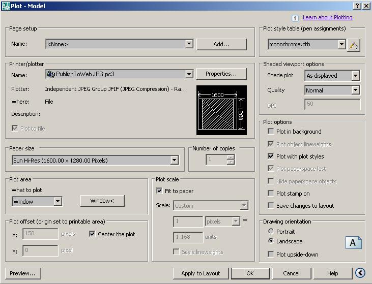

clark Posted November 8, 2009 Share Posted November 8, 2009 Hello everyone, At present, I am using AutoCAD 2009. For the use of Image Rectifying software, I need to use *.bmp image of existing AutoCAD drawing. When preparing *.bmp view, I use normal export command and followed following (General) procedure. [select file type as *.bmp Quote Link to comment Share on other sites More sharing options...
viviancarvalho Posted November 11, 2009 Share Posted November 11, 2009 Try using the plot command instead. The outcome will be jpg file which can be easily converted to bmp. The attached picture of plot dialog box will clear your doubts. Quote Link to comment Share on other sites More sharing options...
clark Posted November 11, 2009 Author Share Posted November 11, 2009 Try using the plot command instead. The outcome will be jpg file which can be easily converted to bmp.The attached picture of plot dialog box will clear your doubts. Dear viviancarvalho , Thanks a lot.I tried it.it is working. Quote Link to comment Share on other sites More sharing options...
viviancarvalho Posted November 11, 2009 Share Posted November 11, 2009 Welcome clark. You can also change the resolution in paper size dropout. Quote Link to comment Share on other sites More sharing options...
