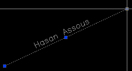

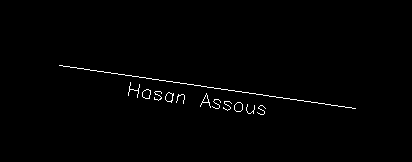

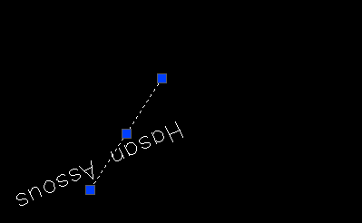

asos2000 Posted February 15, 2010 Share Posted February 15, 2010 Lee Thanks for great lisp Refer to Dynamic Text Curve Align V2.7.lsp there are some points - The alignment not working when line length is shorter than text length(see Attached 1st and 2nd pic). - Is there avaialbilaty to rechange settings? Or Should I DTRemove then DTCurve again? Because text location changed when rotate the line more than 90degree (see Attached 3rd pic). - Some times when repeat the same command DTCurve, the 2 texts colected and aligned to one line (see attached movie), it habbens 2 times. I'll try to study the case and tell you. - Is this working inside Dynamic block even with text and attribute? Bug.zip Quote Link to comment Share on other sites More sharing options...
Lee Mac Posted February 15, 2010 Author Share Posted February 15, 2010 Thanks Hasan, I will look into it Quote Link to comment Share on other sites More sharing options...
Lee Mac Posted February 15, 2010 Author Share Posted February 15, 2010 Hasan, I have updated the code in the Archive to Version 2.8 - it can be found here. I cannot work out what is causing the bug in which you align one object, then a second. Then when realigning a previous object, the last object aligned is used. Quote Link to comment Share on other sites More sharing options...
