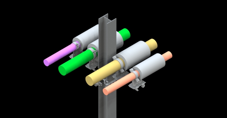

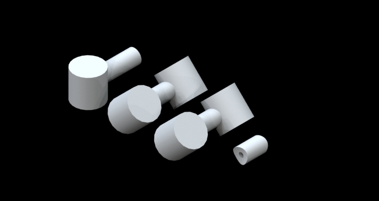

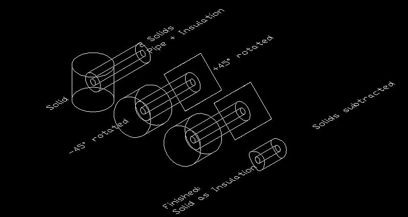

garlictaste Posted January 11, 2010 Share Posted January 11, 2010 Hallo from Germany, I work with 3d piping apps on acad2008. And there is until today no way to draw 3d-pipe-ends or a part of insulation on a pipe. It has to look like the ying yang symbol - but in 3d: Example1: pipe diameter 114,3 mm + insulation 80mm Example2: pipe outer diameter is 168,3 mm with wall thickness 8mm The way I use with solids is allways the same. But it could be very helpfull to have a prog, which draw this automaticly, after giving clicking on the pipe-solid`s end and give the data in. My english is not the best, sorry for that. Hope the pictures are helpfull. - garlic- Iso.dwg Quote Link to comment Share on other sites More sharing options...
wizman Posted January 11, 2010 Share Posted January 11, 2010 What data do you need as output? Quote Link to comment Share on other sites More sharing options...
garlictaste Posted January 11, 2010 Author Share Posted January 11, 2010 ...as shown on the pictures/dwg. With "data" I meant the diameters and the thickness = +Insulation or -Wallthickness. The result should be like a pipe with these "special ends" acad2008 and acad2010 ...did you mean that? -garlic- Quote Link to comment Share on other sites More sharing options...
fixo Posted January 11, 2010 Share Posted January 11, 2010 ...as shown on the pictures/dwg. With "data" I meant the diameters and the thickness = +Insulation or -Wallthickness. The result should be like a pipe with these "special ends"acad2008 and acad2010 ...did you mean that? -garlic- This will get you started I have misundersood with your diameters change all sizes to suit (defun C:SS (/ cpt dia1 dia2 dist dpt ept hgt1 thk2 sol1 sol2 sol3 sol4 spt subsol1 subsol2 thk1) (setvar "cmdecho" 0) (command "._-view" "_swiso") (command "._vscurrent" "_2") (setq dia1 (getdist "\nEnter big pipe diameter <168.3> : ")) (if (not dia1)(setq dia1 168.3)) (setq hgt1 (getdist "\nEnter pipe height <1000> : ")) (if (not hgt1)(setq hgt1 150.)) (setq thk1 (getdist "\nEnter pipe thickness <8> : ")) (if (not thk1)(setq thk1 8.)) (setq dia2 (getdist "\nEnter the conjunction pipe diameter <114.3> : ")) (if (not dia2)(setq dia2 114.3)) (setq thk2 (getdist "\nEnter thickness of insulation <40.0> : ")) (if (not thk2)(setq thk2 40.)) (setq dist (getdist "\nEnter distance between pipe axises <1000>: ")) (if (not dist)(setq dist 1000.)) (setq cpt (getpoint "\nPick center point of the big pipe: ") spt (list (car cpt)(+ (cadr cpt) hgt1)(caddr cpt)) ept (list (car cpt)(- (cadr cpt) hgt1)(caddr cpt)) ) (command "._cylinder" "_non" spt dia1 "_A" ept) (setq sol1 (entlast)) (command "._cylinder" "_non" spt (- dia1 (* 2 thk1)) "_A" ept) (setq subsol1 (entlast)) (command "._rotate3d" sol1 "" "_X" "_non" cpt -45.) (setq sol1 (entlast)) (command "._rotate3d" subsol1 "" "_X" "_non" cpt -45.) (setq subsol1 (entlast)) (setq dpt (list (+ (car cpt) dist) (cadr cpt)(caddr cpt))) (command "._copy" sol1 "" "_non" cpt "_non" dpt) (setq sol2 (entlast)) (command "._rotate3d" sol2 "" "_X" "_non" cpt 90.) (setq sol2 (entlast)) (command "._copy" subsol1 "" "_non" cpt "_non" dpt) (setq subsol2 (entlast)) (command "._rotate3d" subsol2 "" "_X" "_non" cpt 90.) (setq subsol2 (entlast)) (command "._cylinder" "_non" cpt dia2 "_A" dpt) (setq sol3 (entlast)) (command "._cylinder" "_non" cpt (+ dia2 (/ thk2 2.)) "_A" dpt) (setq sol4 (entlast)) (command "._subtract" sol4 "" sol3 "") (setq sol4 (entlast)) (command "._subtract" sol4 "" subsol1 "") (setq sol4 (entlast)) (command "._subtract" sol4 "" subsol2 "") (setq sol4 (entlast)) (command "._subtract" sol4 "" sol1 "") (setq sol4 (entlast)) (command "._subtract" sol4 "" sol2 "") (command "._vscurrent" "_C") (setvar "cmdecho" 1) (princ) ) ~'J'~ Quote Link to comment Share on other sites More sharing options...
garlictaste Posted January 11, 2010 Author Share Posted January 11, 2010 ..I think, I tried to explain it wrong...start only with this: (setq dia1 (getdist "\nEnter pipe diameter : ")) ...is the outer diameter (setq hgt1 (getdist "\nEnter pipe height : ")) ...is the length of the pipe (setq thk2 (getdist "\nEnter thickness of insulation : ")) ...ok The outer diameter of the complete pipe will be then 168,3+40+40 mm. The diameter of the cylinders to subtract is always 2,5 x outer diameter of the pipe, means 168,3 x 2.5 = 420,75mm The height of the cylinders can always be 1,1 x outer diameter of the pipe, thats ok. That should be enough to draw a part like on the picture - I think:unsure:. -garlic- Quote Link to comment Share on other sites More sharing options...

garlictaste Posted January 13, 2010 Author Share Posted January 13, 2010 Hallo, I just made the drawing with the attached code. Hope this helps. -garlic- Thanks a lot:D SS4.dwg SS4.lsp Quote Link to comment Share on other sites More sharing options...
garlictaste Posted January 13, 2010 Author Share Posted January 13, 2010 Is it possible, to give dia1 "Subtract-pipe radius" and hgt1 "Subtract-pipe half length" the same formula: (pipe-diameter + insulation) x 2.5 ? That will give always a nice look of the break on the pipe. Is it possible, to give dist "pipe length max" always the same formula: dia1 x 5 ? After that ther are only the questions for "pipe-diameter" and "insulation thickness" left. That should be really perfect ! (...and complicated ?) - garlic- Quote Link to comment Share on other sites More sharing options...

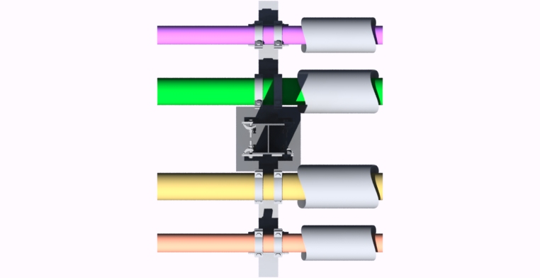

garlictaste Posted January 13, 2010 Author Share Posted January 13, 2010 Hi, I made a quick picture of an example for what this lisp is good. The pipe drawings are made to high quality rendered pictures for the clients - and they want it exact. So every time, I have to show a part of insulation (and this is very often), I draw it extra -much work ! So I am very thankfull for this code - it makes my work much easier and the clients are happy about that - no piping application can do that, and now it looks very good and is much quicker ! Sorry again for my english - not enough experience, but with 3d-pipe:wink: -garlic- Quote Link to comment Share on other sites More sharing options...
ReMark Posted January 13, 2010 Share Posted January 13, 2010 What you have shown above is exactly what we show to the President of our company. Maybe he isn't such a stickler for "detail" as your clients. Keep in mind, it is only insulation. Some people can't see the forest for the trees. I thought you were looking for a Ying-Yang type of effect? The lisp routine doesn't appear to do that. Quote Link to comment Share on other sites More sharing options...

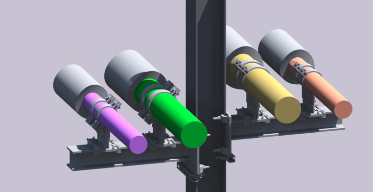

garlictaste Posted January 14, 2010 Author Share Posted January 14, 2010 it was an old one. Here is the new result, and it`s super. In finished rendrings it show different materials for rockwool isolation material an aluminium covers. yes, I am very happy with this. The only thing that could be made better, is to input the diameter instead of radius. Quote Link to comment Share on other sites More sharing options...
garlictaste Posted January 14, 2010 Author Share Posted January 14, 2010 ..sorry I forgot.. -garlic- Quote Link to comment Share on other sites More sharing options...

ReMark Posted January 14, 2010 Share Posted January 14, 2010 I see you achieved the desired results. Nicely done. It still begs the question as to what value it adds to the drawing? The word superfluous comes to mind. A lot of effort has gone into making the insulation appear "just so" yet the pipes are shown as completely solid. What's up with that? How is the insulation fitted around the pipe clamps? Quote Link to comment Share on other sites More sharing options...
