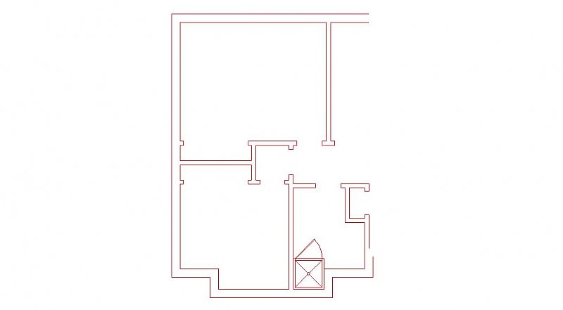

facad Posted March 10, 2010 Author Share Posted March 10, 2010 Thank you ReMark and Noahma for your time:)! I did combine both of your orientations and came up with this floor plan (not final). Please see attachment. I did work on the rooms, home office and bathroom. I replaced the bathtub with a shower, in order to gain some space for the bedroom. The plumber may get mad at me. I did not have a space in the same wall in order to put the sink! The main entrance should remain in the same place as by my professor, I cannot shift it! The bump out is bothering me too, but I cannot make changes on the outside wall; as by the professor). The wall between the kitchen and the dinning room should be a bar (I do not know how to put a bar there), I check the design center, I did not see what I want; it is my first class project:unsure:! Please not that I did not finish my kitchen and dining room, it’s getting late, I will do it tomorrow! Note: I wanted to redimension my new floor plan in a sheet, but I cannot erase the previous dimensions , neither add new ones, did I miss something? myhouse.pdf Quote Link to comment Share on other sites More sharing options...
ReMark Posted March 10, 2010 Share Posted March 10, 2010 Master bedroom: No comment at this time. Addendum: You might consider stealing 6" from this room and adding it to the home office. Home office: I would make the distance from the lower left hand corner of the room to the door jamb the same as it is for the master bedroom. The door will open tight to the wall. Kitchen: Put the sink directly in front of the window. The wall where it is now should have a pass-through to the dining room. Put counters on either side of the sink. The stove and refrigerator need to be reoriented. Come back to that later. The 2nd bedroom is too small. Look at how little space you have left between the left hand side of the bed and the wall and the same thing goes for the space between the foot of the bed and the closet wall. Now that you eliminated the door on the right hand side why not capture some of that space and use it for the small bedroom? Bathroom: A person cannot use the toilet with the corner of a closet wall practically on the centerline of the toilet itself. Delete the closet. You have to move the sink away from the shower stall otherwise a person cannot fully open the door to the shower. Your dimensions are so small I cannot read them. Could you please provide us with the actual length and width of the house? Are you using 2x4 or 2x6 construction for the exterior walls? I'm guessing it is 2x6. Addendum: The exterior walls are much thicker than I had first surmised. Is the house going to be brick by any chance? Quote Link to comment Share on other sites More sharing options...

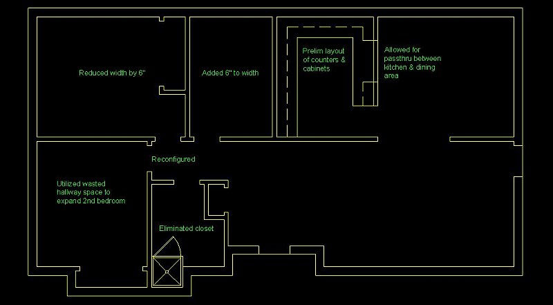

ReMark Posted March 10, 2010 Share Posted March 10, 2010 Maybe a sketch will help clarify the points I made in my previous post. The "white" house, top image, is your basic design minus of few elements such as door swings, windows, etc. The "yellow" house, bottom image, is your basic design revised as per my comments. Note I stole 6" from the master bedroom to make the home office a bit wider. Quote Link to comment Share on other sites More sharing options...

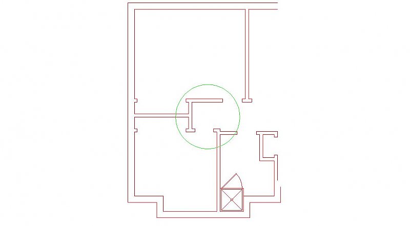

ReMark Posted March 10, 2010 Share Posted March 10, 2010 Another option re: bedrooms. Quote Link to comment Share on other sites More sharing options...

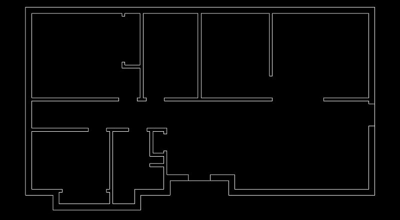

ReMark Posted March 10, 2010 Share Posted March 10, 2010 I forgot to clean up a couple of lines. This is the corrected version. Quote Link to comment Share on other sites More sharing options...

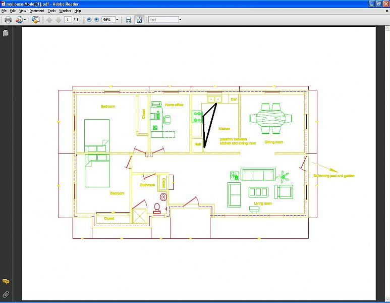

facad Posted March 11, 2010 Author Share Posted March 11, 2010 Pardon me! this is the right drawing! myhouse-Model.pdf Quote Link to comment Share on other sites More sharing options...

ReMark Posted March 11, 2010 Share Posted March 11, 2010 Alright, I've had a look at your latest plan and I do have one comment. Refer to the image below. See the black triangle I've laid out in the kitchen between the sink, stove and refrigerator? OK...it doesn't work. The legs of the triangle should be relatively the same length and they aren't. It's too many steps from the refrigerator to the sink. In my opinion the refrigerator should go on the wall that separates the kitchen from the dining area. I would also suggest moving the dishwasher closer to the sink because most new houses have garbage disposal units under the sink. People scrape the plates off, rinse them then stack the dishwasher. Quote Link to comment Share on other sites More sharing options...

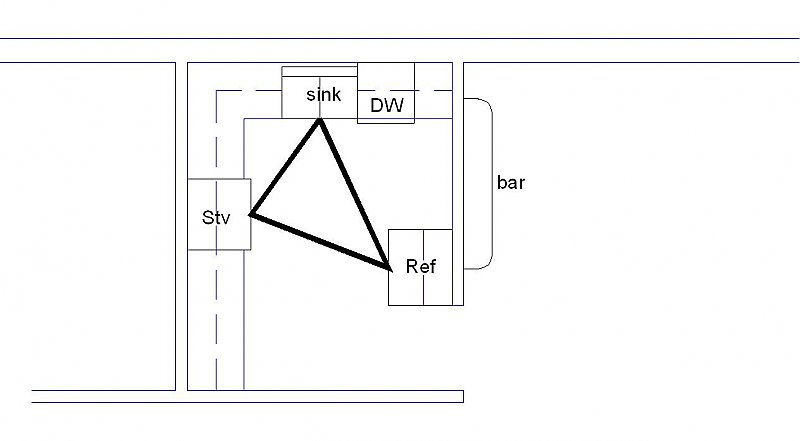

ReMark Posted March 11, 2010 Share Posted March 11, 2010 The image below illustrates my point about the sink, stove and refrigerator work triangle. I added a "bar" or "breakfast shelf" or whatever you want to call it. I imagine it would be high enough off the floor that stools could be used instead of chairs. Quote Link to comment Share on other sites More sharing options...
