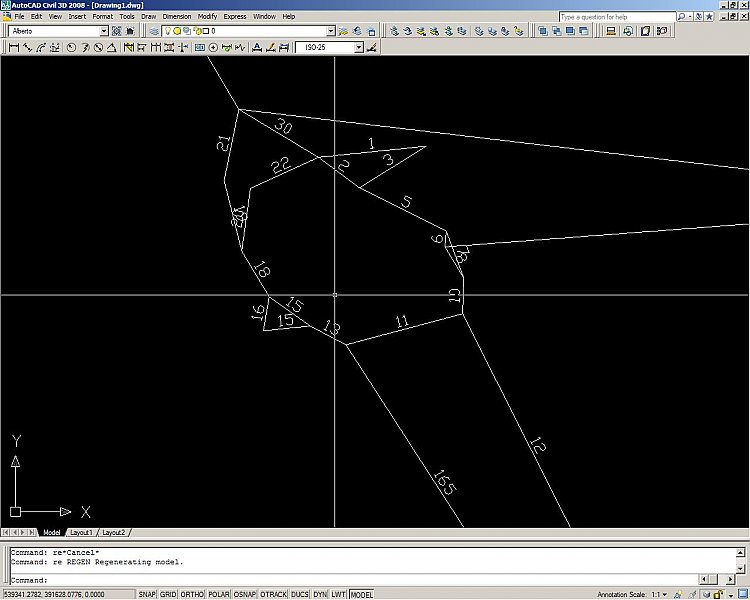

BlackAlnet Posted March 5, 2010 Posted March 5, 2010 Really? The last one works fine here.See the image attach. Edit: I could do a lisp for it, but the "work how" of the lisp will be the same as the excel sheet. Quote

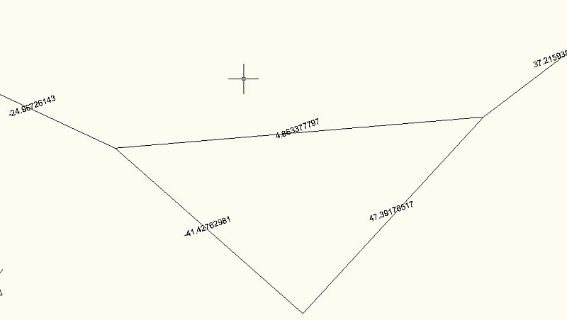

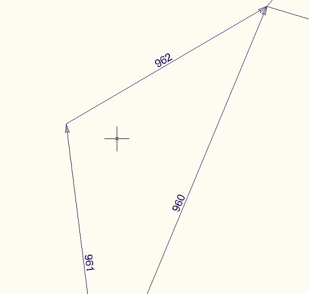

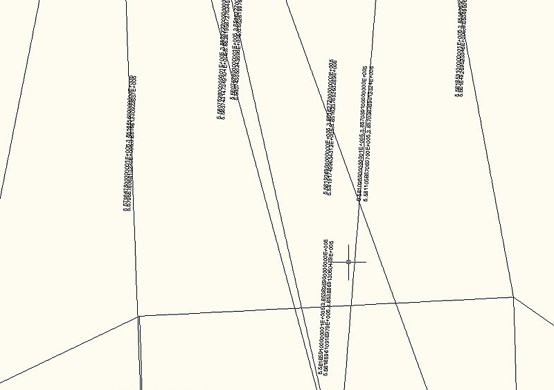

tomjas Posted March 8, 2010 Author Posted March 8, 2010 Hi BlackAlnet Thanks for your effort. I’ve noticed that you are using Civl 2008. I’m using CAD 2010 (and still have 2009 installed). Unfortunately is not working with those versions (see screenshot). I thing that -text function is a bit different in 2010 (and 2009) than 2008, because is using value 20 as a text rotation angle rather than text size. And if you delete let say 200 rows- is still preparing those 500 links. Based on your ideas- I’ve prepared excel spreadsheet which is working in CAD 2009 and 2010. It’s not perfect but is working. This will ‘detect’ how many rows of data you have, there is no option for text height (you can change it easily in CAD), you still have to be in first spreadsheet when running macro… but is doing what I need. Once again thank you very much for your effort and ideas. Regards, Tom P.S. Maybe you know how to place a block on the end (end point with the same rotation angle as line) of each line (which I've changed to pline), so I can see 'direction' of each link? If we will place let say arrow block on the end of each pline using lisp -that will be just great :wink: Links.zip Quote

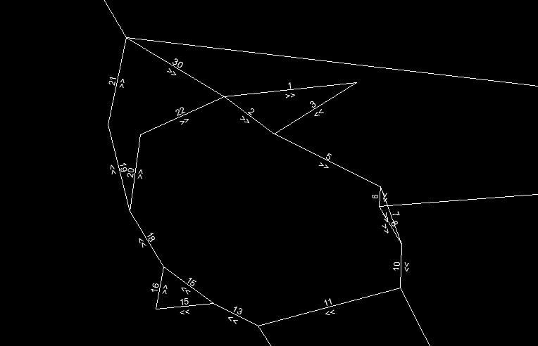

CM Hew Posted March 9, 2010 Posted March 9, 2010 I have some routines that I use for my work, importing xy coordinates and using information to set out etc... I have adapted one of the routines to plot the labels between the coordinates. But the drawback is the arrow diagram which is a text ">" depending on the input coordinates. Load XYmore.lsp and type "XYmore" to run. In the dialog box, select the XYmore CSV file that I have created using your data. Choose appropriate text height when prompted. Zoom "all" to view. Hope this works for you xymoreLSP.lsp xymore txt.txt Quote
tomjas Posted March 9, 2010 Author Posted March 9, 2010 Results on my machine are 'slightly' different (see screenshot with black lines) I've sorted this one using excel (see screenshot with purple lines- but still no luck with text height) but one nice lisp routine will be much better... Quote
