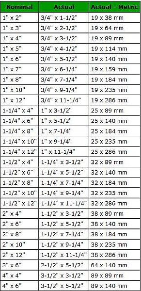

extremeregime Posted March 8, 2010 Posted March 8, 2010 This must be the most dumbest question that is probably asked on the forum, but I do need the answer to it. As school is not providing me the answer. Say I am drawing a deck. Low deck, less then 2ft in height. Using 2x8 lumber for structure. 2x6 for floor boards, 4x4`s for posts, etc.. What size on the drawing would I draw the 2x8 for example? Would I use the actual 2x8 measurement or would I use the actual size of a 2x8 (2 1/2" x 7 1/4")? Again its a little dumb of a question, but like I said school is not provding the answer. School is just saying "here is assingment, draw what is asked (either your own creation or reproduce an drawing) and hand it in". I would really like to know the asnwer for two reasons. (1) Clearity (2) I'm actually submitting drawing to my municipality to get a building permit for a deck and I would like to sumbit it done proper, I don't want the paper to come back with a bunch of red lines and one line being your measurements for your lumber are wrong. Quote
kencaz Posted March 8, 2010 Posted March 8, 2010 Draw the actual size of the object and always 1:1 scale. KC Quote
extremeregime Posted March 8, 2010 Author Posted March 8, 2010 I always use 1:1 scale. To get this correct, if I am drawing a 2X8, I would draw it the exact measurement 1 1/2" x 7 1/4" x length? Quote
kencaz Posted March 8, 2010 Posted March 8, 2010 I always use 1:1 scale. To get this correct, if I am drawing a 2X8, I would draw it the exact measurement 2 1/2" x 7 1/4" x length? Yes, however, I believe it's 1-1/2... KC Quote
Pablo Ferral Posted March 8, 2010 Posted March 8, 2010 Draw it at 1:1, exactly how it would be when it's finished. Bear in mind who the end user is and what they are looking for from your drawing. If you give you deck drawing to a carpenter and he assumes that all your timber planed (Beacuse this is what you want), but youv'e drawn it as sawn lumber, he will cut all the parts to your drawing dimensions, and then find they don't fit... The place to show sawn and planed dimensions is in a cutting ticket, much as Kencaz has shown above. Quote
eldon Posted March 8, 2010 Posted March 8, 2010 And when you dimension the structure, show centre to centre measurements. That way the actual sizes are not significant. Quote
ReMark Posted March 8, 2010 Posted March 8, 2010 Draw the lumber based on the actual sizes as you see them in the chart provided by kencaz. However, you call out the lumber just as you indicated i.e. - 2x8, 2x6, 4x4, etc. Note: 2x6 = nominal or rough size. 1 1/2x 5 1/2 would be the "dressed" size (after material is removed via planing process). Quote

Dana W Posted March 25, 2010 Posted March 25, 2010 Thanks guys for the posts. I will be using the actual sizes for when I do my drawings from no on. I have drawn house plans for some of the major home builders in my area since 1971, and I have always drawn framing plans at actual lumber sizes and never had any architect expect any different. The walls are always dimensioned stud face to stud face as well. Only the framing carpenter cares where the studs and joists are. Everyone else just works with what they find to hack them full of wire, pipe, and duct passages, and hang sheetrock on them. When you draw your deck, start the joist spacing at the first outside face of joist, dimension over to the nearest face of the second joist using the center line modulus, minus half the thickness of one joist. For example, at 16" o.c. your first dimension will be 15 1/4", and all the rest will be 16" from same face to same face. Lumber does not come with center lines and a framing carpenter will not use your dimensions if you dimension to the centers of joists. He or she will lay it out correctly, he will just igonore your numbers. This stuff must fit together out in the field. Worry about the framing carpenters and not the architect, and please, do some research on proper framing techniques and requirements so you won't have to take a jar of vaseline with you to the permit office. Quote

ReMark Posted March 28, 2010 Posted March 28, 2010 I think most of us agreed that lumber is drawn at actual and not nominal size. As for 16" same face to same face isn't that just like saying center to center? The measurement will be the same. Maybe the proper place to change our perspective is in the classroom where most architectural design/drafting courses teach center to center dimensioning. Building requirements for some things, such as decks, can sometimes be found right at the local building department. If you're building a house you better know what code your state follows. Quote
Dana W Posted March 29, 2010 Posted March 29, 2010 I think most of us agreed that lumber is drawn at actual and not nominal size. As for 16" same face to same face isn't that just like saying center to center? The measurement will be the same. Maybe the proper place to change our perspective is in the classroom where most architectural design/drafting courses teach center to center dimensioning. Building requirements for some things, such as decks, can sometimes be found right at the local building department. If you're building a house you better know what code your state follows. That's the whole point, for the measurement to be the same. But once again, framing lumber does not come with center line markings on them and given the quality of today's lumber, that is a good thing. You can also google up most county code requirements. The framing carpenter will start at one outside surface, usualy the right front corner, and lay out the joists face to face no matter what you put on a drawing because he does not have a center line to use. In my first drafting class, in 1970, I was not taught how to dimension framing plans, and I was taught that walls were 4" thick. One year later at my first real world drafting job, I discovered what realy goes on out there. Quote
