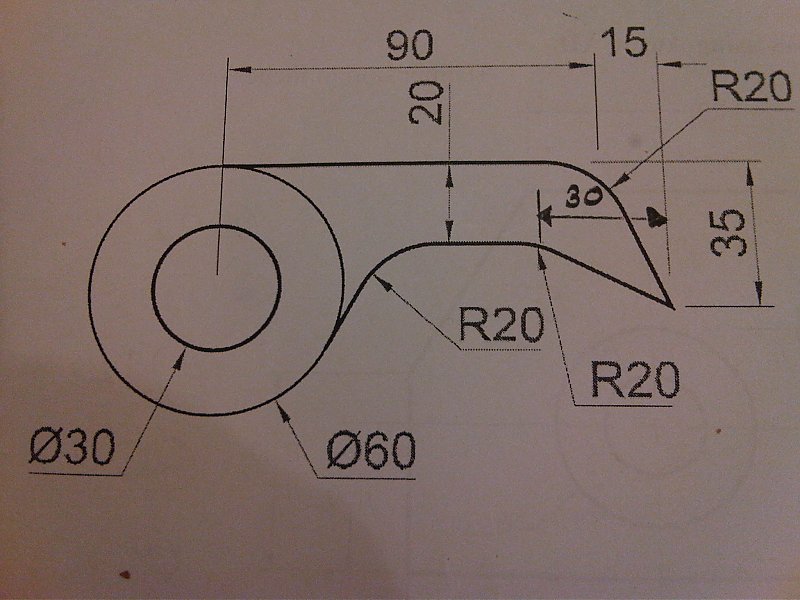

kuwait Posted March 10, 2010 Share Posted March 10, 2010 hi every body :-) please tell me how to draw this figure Quote Link to comment Share on other sites More sharing options...
Fire_col Posted March 10, 2010 Share Posted March 10, 2010 I'm assuming you've had a go at it already? What part are you struggling with? Quote Link to comment Share on other sites More sharing options...
ReMark Posted March 10, 2010 Share Posted March 10, 2010 Seems fairly straightforward. A couple of circles, a few lines, three arcs and you're done. Start drawing and when you get truely stuck come back with your question. Please draw the object FULL size in model space. Don't forget the TTR option available in the Circle command. Other commands that might come in handy: trim, offset and fillet. Quote Link to comment Share on other sites More sharing options...
kuwait Posted March 10, 2010 Author Share Posted March 10, 2010 please help me i really dont know how to draw it Quote Link to comment Share on other sites More sharing options...

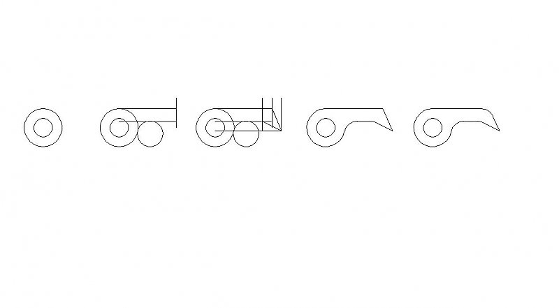

ReMark Posted March 10, 2010 Share Posted March 10, 2010 One possible approach. Just depends on what commands you use and the sequence you use them in. Quote Link to comment Share on other sites More sharing options...

Fire_col Posted March 10, 2010 Share Posted March 10, 2010 So you've been set an assignment to use AutoCAD without being taught how to use the basics of AutoCAD? ReMark has nailed it, that's the same method I would use myself. Quote Link to comment Share on other sites More sharing options...

ReMark Posted March 10, 2010 Share Posted March 10, 2010 Start with drawing the two circles first. You have been given the diameters of 30 and 60. It does not matter which one you draw first. If you draw the inner one first pick where you want to place the centerpoint on the screen then stop. Look at your command line. AutoCAD asks you to “Specify radius of circle or [Diameter]. We know the diameter. Type “D” then press Enter. Specify the diameter of the circle by typing “30” then press Enter. Your first circle has been drawn. To draw the outer circle you could elect to repeat the above steps or you can use the Offset command. Let’s use Offset. You’ll find the command on the Modify pull-down menu. Other options for invoking the command include clicking on the command’s icon or using the command alias (a keyboard shortcut) in this case it is “O” for Offset. It’s your choice. No matter which you choose AutoCAD will ask you to “Specify offset distance or [Through/Erase/Layer] .” We want to supply a distance. Subtract the diameter of the inner (smaller) circle from the outer (larger) circle and divide the result by 2. Your answer should be 15. This is the number we type in followed by pressing Enter. When AutoCAD asks you to “Select object to offset…” pick the inner circle. When AutoCAD asks you to “Specify point on side of object to offset…” pick anywhere outside of the inner circle. Press Enter to escape out of the command. Stop. Before going any further please save your drawing. Use a name that has meaning to you like Assignment1. Save often and in the event of a crash you won’t have to worry about starting from scratch. Quote Link to comment Share on other sites More sharing options...
kuwait Posted March 10, 2010 Author Share Posted March 10, 2010 thank you so much ReMark i finished it and for eatonpcat Quote Link to comment Share on other sites More sharing options...
