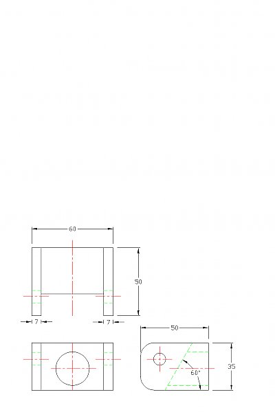

kuwait Posted April 7, 2010 Posted April 7, 2010 hiiiiiiiiiiiiiiiiiiiiiiiiiiiii i have a problem i really cant draw this one this is what i reached kuwait.dwg Quote

JD Mather Posted April 7, 2010 Posted April 7, 2010 The 4 R10 fillets will not be visible in front view - only right side view (as 2). Quote
ReMark Posted April 7, 2010 Posted April 7, 2010 JDM: In your opinion does the center hole punch all the way through the object or stop short of doing that? I ask because when I constructed the object and subtracted the center hole I wasn't pleased with the results. Something didn't look right. I'm not trying to be a wise guy here. Thanks, in advance, for your comments/suggestions/observations. Quote
JD Mather Posted April 7, 2010 Posted April 7, 2010 Common problem assigned by instructors to see if student can figure out elliptical breaks through bottom and back. I'm making the assumption here that the OP can't figure out how to open the DWF and "cheat". In any case didn't totally give away the ortho views. Getting the hidden lines will still be a bit of work (from 2D rather than 3D). HomeWork.dwf Quote

rkent Posted April 7, 2010 Posted April 7, 2010 Guys, the OP is having trouble visualizing the orthographic views of the iso. This is the beginners section, of course it is an easy part to draw for those of us that know how. Telling them it is easy doesn't provide any help what so ever. kuwait - I have attached the start of the different views. You will need to work hard on rotating the iso object in your head to only see the front, top and right sides. Hopefully seeing some of the finished product will help you. I just noticed the note to modify the large hole to be perp to the sloped surface so my views will not show that hole propertly. Was just trying to get you going without taking too much time away from work. Quote

JD Mather Posted April 7, 2010 Posted April 7, 2010 Guys, the OP is having trouble visualizing the orthographic views of the iso. This is the beginners section, of course it is an easy part to draw for those of us that know how. This sort of problem is normally covered in a class lecture before given as an assignment. At a minimum I would expect a reading assignment of a similar problem. Common problem assigned by instructors to see if student can figure out elliptical breaks through bottom and back. The 3D solution I posted might have been better for visualization purposes in trying to find the orthographic solution rather than merely giving the (incorrect) solution. Quote

ReMark Posted April 8, 2010 Posted April 8, 2010 Thank you JDM for the DWF. Turns out I got it right after all. It was the elliptical breaks that kind of threw me there for a moment. It's funny we haven't heard back from the OP. Maybe he was testing us? Quote
ReMark Posted April 8, 2010 Posted April 8, 2010 Haven't had any trouble opening the files that have been posted so far. Maybe I got here after they were fixed and reposted? I'd consider doing the drawing in 3D then extracting the necessary 2D views unless the assignment was to use 2D exclusively. Hint: If you are attempting this in 3D create the basic plan view and extrude it the required height. Then use the Taper Faces command to create the sloped center section. Pay close attention to the command prompts. It may take you several tries before you get it right. Another hint: use 30 as the taper angle. Good luck. Quote
