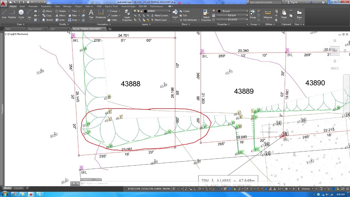

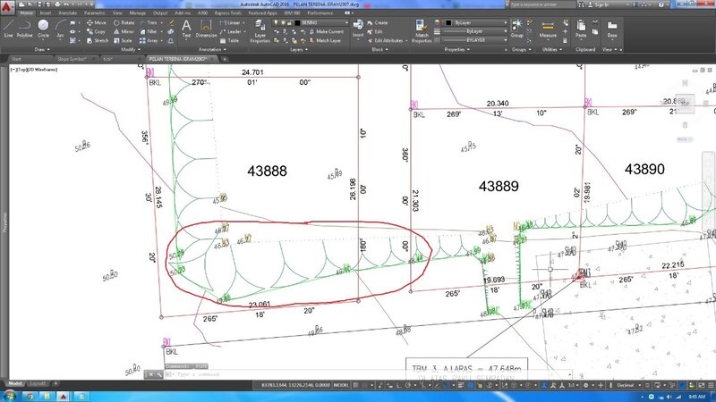

shahAbdul Posted December 27, 2022 Share Posted December 27, 2022 hello everyone, how to create slope line like this Quote Link to comment Share on other sites More sharing options...
