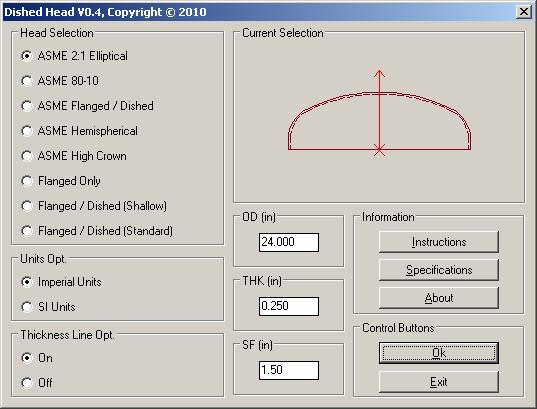

I have another entity make program for you to try out. Back some time this type of program was requested. I noticed a couple of threads on the subject, But there was nothing quite elaborate as this program.
The program draws 2D ASME Coded Elliptical heads and Non-Coded Heads. It creates the head outline as a closed polyline with a thickness line. Each are placed on separated layers. There is an option to draw just the outline without the thickness line and also an option to create these heads in SI units.
The program has an instructions dialog and changeable images of your selections. I have provided the source coding for you to edit if you wish, But I request that if you make changes and post, Do not remove the headers and be sure to record your changes as a revision and add to the header. Please do not post changes to this thread.
If you are unsure about how to edit this code, I will be happy to answer your questions.
The command syntax for this program is DH.
See below for the attached Zip file.

A Great looking dialog Buzzard, well done :)
Thanks Lee,
But I am not overly concerned about the dialog appearance as much as what the program does and how it does it. I would appreciate any comments concerning this. As you may realize my programming looks the same in all my programs, But its output is different. I have got some great tips from you and put it to use.
Thanks to you and Alan for your help before with the trig related problem for this code.

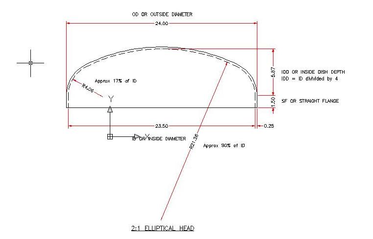

Just a little information for you concerning head radius's.
The 2:1 head IDD or Inside Dish Depth can be determined by dividing the ID or Inside Diameter by 4. Note that this only applies to the 2:1 head only. This make the IDR or Inside Dish Radius slightly over 90% and the IKR or Inside Knuckle Radius slightly of 17%.
The other heads IDD are a result of the combination of IDR or Inside Dish Radius and IKR or Inside Knuckle Radius. These can vary from manufacturers, However the radius's used in this program are typical for the type of head they are assigned to. These values can be changed in the program if needed.
If you have any actual specifications concerning these dimensions, I can set the program up for you accordingly.
See image below.
