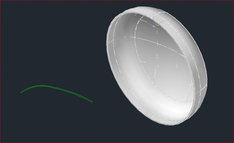

I am new to this forum, although I have been a lurker for quite a while and have benefited greatly from all the advice given here. But I need some assistance for 3D dished ends and this may not be the right thread to ask for help. But you guys seem to be very knowledgeable on LISP code and especially Buzzard's dished end code.
Is there any way that Buzzard's code will put the dished end in the Z axis. I have used his LISP code to produce dished ends, but they always draw on the X or Y axes. I want to make a 3D dished end, but I am not able to do so.
Any assistance will be appreciated.
What is so difficult about rotating the dished head after creating it in the X/Y axis?
As I said, I have done many 2d drawings, but this is my first foray into 3D. I have tried the REVOLVE command, but all I get is strange shapes.
I want to add the dished end to a cylinder, which is a standard 3D shape, but I have no idea how to create the dished end in 3D.
Buzzard's LISP helped me create the 2D dished end, but it is only a 2D shape.
it always work great, need to know how.
See below:
Ok, thanks. I got it to work, but the dished end is as per your drawing. Please have some patience with me, I do not know many of the 3D commands.
How do I rotate the dished end so that the opening is horizontal. The tank will be a vertical tank with legs attached to the dished end.
Thanks. Barry
Reorient your UCS then rotate the head.
Thanks for all the help. I was able to get the dish into the correct orientation.
