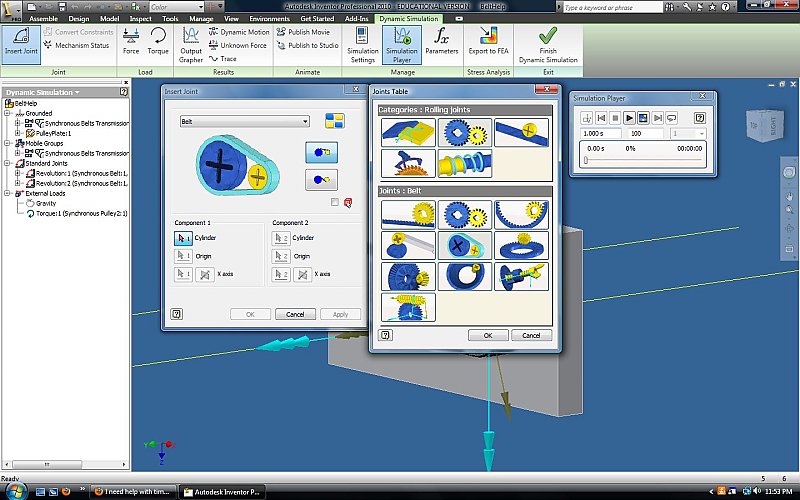

what I need to do is to make one pulley to drive the timing belt and the belt to drive the other pulley
I can't upload here the file is too big..but i rendered a pic hoping it would help you figure
When you created the pully/belt setup, did you use the design synchronous belt feature?
regardless, when you are in dynamic simulation you need to insert a joint. There is a joint called "belt". It will let you select both pulleys. The standard origin of each part should be correct(i.e. no need to select anything for the origin). Just make sure the arrow hats are correct. They arent labeled x,y,z but there will be 1arrow, 2 arrows and 3. Once you insert this joint, and add your torque to one pulley, the other will move. Depending on how your pulley is connected to the shaft, you may need to insert a contact joint as well.

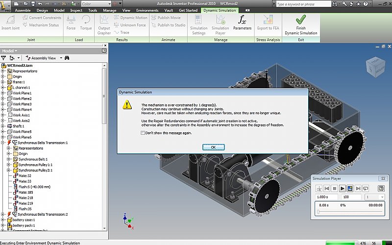

yea i use synchronus belt..and i did exactly what u told me..but it says the mechanism is over constrained by 1 degree..what is that from?
i attached a pic with the error here.

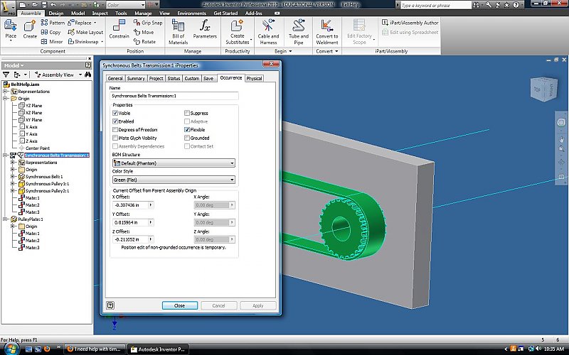

Either something is grounded or your assembly is rigid. You need to right click on your belt assembly, go to properties and make it Flexible. When you create a belt setup it automatically grounds the belt which is okay(i dont think you can "un-ground" it) but with a rigid assembly everything will be locked.
When you right click on your assembly and iProperties is selected. Go to the Occurrence tab. Here you will see flexible. Also note the icon in the feature tree to let you know this subassembly is flexible.

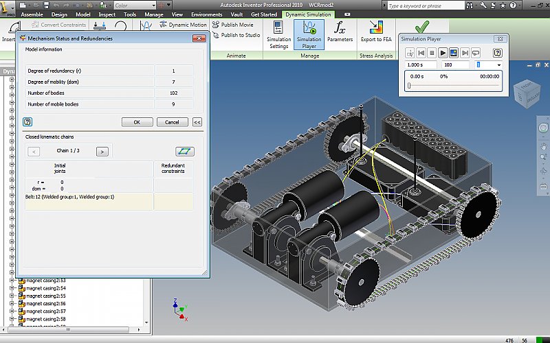

i cant get that site to load. Open your file in dynamic simulation and click on the Mechanism Status button and upload a screen shot of it.

Is that lightning sign the reason for the conflict?will it be able to move appropriately if i chose the standard lenghts? here is the attached pic
No the lightning bolt will(should) not have any effect on that. It only lets you know how the sub-assembly was designed. There is the manual method(no solver and no icon), the manual solver and the auto solver. The auto one i believe is a circular icon similar to adaptive but not the same.
You can see you have 1 redundant joint. you can see it says chain 1 of 3 and lists the chain below. Cycle through all 3 and see which one has the redundant constraint. Im going to guess that since you have two sets of belts/pulleys that is it. You wont need two belt/pulley joints if they are connected by a shaft(fixed to the shaft).

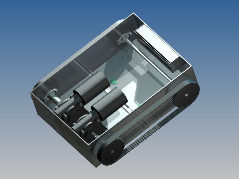

I need to demonstrate its working idea..that the two motors in the middle can rotate the pulleys and drive the belt with magnets bolted along its circumference to stick to ferromagnetic surfaces without sliding..I'm not building a prototype so getting this assembly to work is crucial.
concerning Ineventor tasks I want to make a dynamic simulation for the drive system and get a video rendering ,and also stress analysis to main components such as shafts,frame,couplings,bolts,nuts etc..
