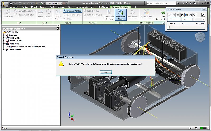

chemicalboy Posted May 5, 2010 Author Share Posted May 5, 2010 the belt moved successfully when i made it solid not detailed,but why doesnt the detailed one move?? Quote Link to comment Share on other sites More sharing options...
shift1313 Posted May 5, 2010 Share Posted May 5, 2010 the belt moved successfully when i made it solid not detailed,but why doesnt the detailed one move?? I dont think the belt actually moves, just the pulleys. It has to do with the teeth on the belt i believe. It almost sounds like some post work putting a few gif's together might work in your case. Here is one video from youtube. http://www.youtube.com/watch?v=kJpN6pVEjrs if you look closely at it, the belt and pulley are not actually moving together(out of time). Quote Link to comment Share on other sites More sharing options...
JD Mather Posted May 5, 2010 Share Posted May 5, 2010 Here is an example one of my students did (see very last one in this series). http://home.pct.edu/~fahmat42/Portfolio.wmv This is similar to how I would do it with the belt actually a series of individual parts as the fudge. The timing would be synchronized with the pulleys. Quote Link to comment Share on other sites More sharing options...
chemicalboy Posted May 5, 2010 Author Share Posted May 5, 2010 how did that video creator on youtube make that belt move along with the pulley? Quote Link to comment Share on other sites More sharing options...
JD Mather Posted May 5, 2010 Share Posted May 5, 2010 You might like this one too - http://inventorparts.com/Animations/LegoCatChain.avi Quote Link to comment Share on other sites More sharing options...
chemicalboy Posted May 5, 2010 Author Share Posted May 5, 2010 amazing..where do i get that? Quote Link to comment Share on other sites More sharing options...
chemicalboy Posted May 7, 2010 Author Share Posted May 7, 2010 hey guys..I recreated the belt with solid look instead of detailed (i.e: no teeth visible) but the problem is that it keeps telling me that the distance between two pulleys must be fixed,and i double checked them and they were fixed!! Quote Link to comment Share on other sites More sharing options...
