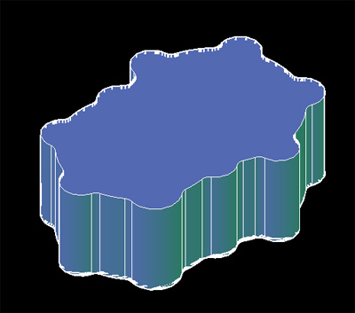

tottiekop Posted August 29, 2008 Share Posted August 29, 2008 Hi I'am trying to make this base plate a solid, it's a closed polyline but as soon as I have extruded it the result is not a 3d solid but it ends up with no top or bottom as if I have used line segments from the beginning? What am I missing Thanx drawing vir online help 2.dwg Quote Link to comment Share on other sites More sharing options...
ReMark Posted August 29, 2008 Share Posted August 29, 2008 It's possible that it is not an entirely closed polyline. How can you tell? Use the CONVTOSOLID command on it. One object is found. However, the command fails. The user is told "Cannot convert an open curve." There is a "gap" somewhere. Quote Link to comment Share on other sites More sharing options...
Cad64 Posted August 29, 2008 Share Posted August 29, 2008 Your Polyline is not closed. I just went through and made sure that all your arc endpoints were snapped together, endpoint to endpoint. Then Converted to Polyline and Joined all segments. Now when I Extrude, I get a Solid. Quote Link to comment Share on other sites More sharing options...
tottiekop Posted August 29, 2008 Share Posted August 29, 2008 Thanx for the quick response I see what you mean : Command: convtosolid Select objects: 1 found Select objects: Cannot convert an open curve. What i did was i took the base when it was all pieces of line segments and used the pedit command and then joined them to make it a polyline. Do you have any suggestions how to find that open curve?? Quote Link to comment Share on other sites More sharing options...
tottiekop Posted August 29, 2008 Share Posted August 29, 2008 your to quick for me..... I founded the problem, Thanx a mill. Have a good week-end Quote Link to comment Share on other sites More sharing options...
