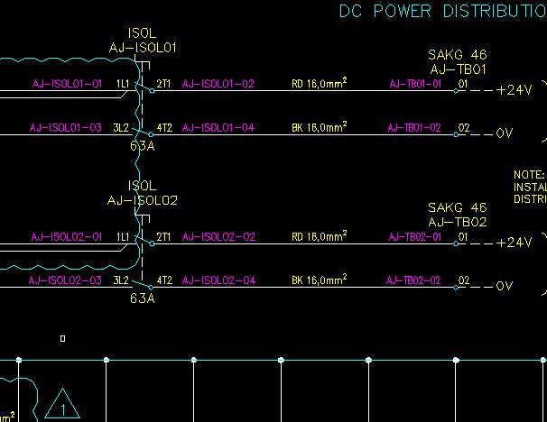

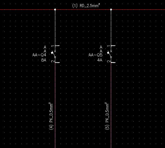

We don't have wire numbers but we mark both ends of the wire with the terminal number. We do this on our drawings and export the text to be printed on a heat shrink marker. We have been told (several times) that ACADE can't do exactly what we want (just the terminal number the wire is hanging on) but it can have the terminal number of both ends of the wire. This is what I am trying to do - without success. If youtrip over it at some time, let me know please. :)
a demo...
this is what we have (top)
and this is as far as I have got (lower)
you can see I have un-hidden a couple of attributes that I am hoping to get involved in the future but at the moment they only contain what is showing on the wire.
I have found a report that (almost) gives what we want but I wanted it on the drawing.. :(
Terminal numbers - both ends.
