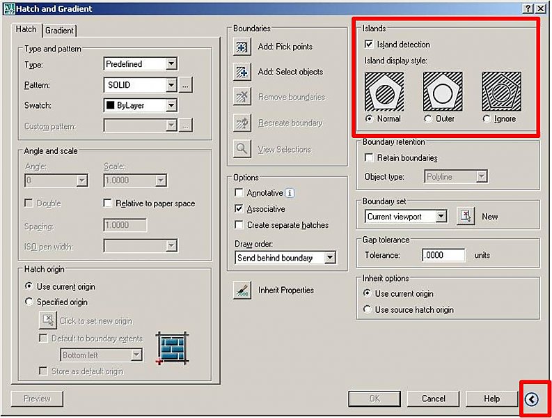

bobsy852 Posted May 21, 2010 Share Posted May 21, 2010 I know i commented about this on the end of a topic yesterday, and I figured out the wipeut tool, however, today I am having to enter a lot of text into hatched areas, and to make the text more elegible, i could do with the hatching being wiped out around the text. Is there any way so it does this automatically (without re-hatching) or do I have to do it manually with the WIPEOUT tool? Thanks again everyone Quote Link to comment Share on other sites More sharing options...

Ryder76 Posted May 21, 2010 Share Posted May 21, 2010 Not sure if you have this in LT or not, but in FULL there is a pull out dialog to the bottom right of the HATCH dialog. You get an Island detection area. See below... Quote Link to comment Share on other sites More sharing options...
ScribbleJ Posted May 21, 2010 Share Posted May 21, 2010 Does AutoCad LT lack the ability to select text in the hatch command? Any text that is selected inside a hatched area will be treated as an island and will not have hatching behind it. If it is a hatching already in place then edit hatch and select the text by Add: Select objects. Quote Link to comment Share on other sites More sharing options...
bobsy852 Posted May 21, 2010 Author Share Posted May 21, 2010 I have my hatching set up the same way using that island detection tool Ryder! It detects any text that's already there but I'm currently trying to add text after I've hatched my fields. And it's an awful pain to re-hatch them! Glad I'm not the only 1 with this problem Dana! So far I've set up 1 with a wipeout and then copied it around! It's ok for notes with all the same size text, but a right pain if i want to change the text size or text note! because then you have to re-do the wipeout box again! Quote Link to comment Share on other sites More sharing options...
bobsy852 Posted May 21, 2010 Author Share Posted May 21, 2010 That's the ticket Scribble! Put in the text you want, then edit the hatching and press "select objects" and then select the text and ok the hatch...HEY PRESTO! no hatch behind the new text! Thanks for that Scribble! you just saved me a load of work! Quote Link to comment Share on other sites More sharing options...

ScribbleJ Posted May 21, 2010 Share Posted May 21, 2010 Could you please say how you did the edit on the hatch? This seems to be the easiest solution for me.Thanks Glenn 2009LT Either double click on the hatching or type in HATCHEDIT at the command line. Quote Link to comment Share on other sites More sharing options...
gsksun4 Posted May 21, 2010 Share Posted May 21, 2010 Either double click on the hatching or type in HATCHEDIT at the command line. Yes, thank you, but now that the hatch tool is open then what? Quote Link to comment Share on other sites More sharing options...
ScribbleJ Posted May 21, 2010 Share Posted May 21, 2010 Yes, thank you, but now that the hatch tool is open then what? I already explained this. See my first post in this thread. Quote Link to comment Share on other sites More sharing options...
