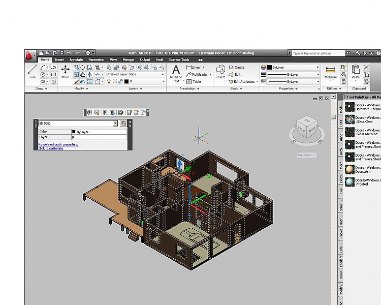

I drew a basic floor plan and used the Boundary/Region/Extrude commands. After I extruded the walls, I unioned them all together to get rid of the seams at the various wall points.
Whenever I try to add a texture to a section of wall (living room for example), the entire wall section of the house changes to the same texture.
I'm trying to figure out how to not physically delete objects from a union, but to remove them from the grouping property of the union command.

You can use Imprint to separate faces for textures. Simply draw a rectangle (or other shape) on the face you want to split and then use the solidedit imprint command. (If the face isn't planar there is an extra step required of extruding first.)

The first pic is the general floor plan.
The second one is the obvious selection whenever I select any part of the wall.

In your pretty picture I do not see anything to imprint to split the faces. You might want to check Help on Imprint or go through the tutorials in my signature.
Actually looking at your picture again, unless you want to apply multiple textures to one face you should not need to use imprint to split the faces. You should be able to use the painter to apply to individual faces rather than the entire solid.

Command: IMPRINT
Select a 3D solid or surface: Select your solid; that would be your wall.
Select an object to imprint: This would be a retangle, for example, that you have drawn on your wall.
Delete the source object [Yes/No] : The default is "No". Not sure why. Maybe AutoCAD expects the user to repeat the command using the same object elsewhere.
At this point AutoCAD will "imprint" (think of it as "stamping") your wall with the shape of the rectangle.
Select an object to imprint: AutoCAD continues to repeat the command. Press Esc to cancel.
Now you can color a face or apply materials to two or more sections of one wall even if in your case that wall wraps the entire house inside and out.
