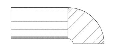

I added cylhatch.lsp (cylinder hatch) which I posted earlier.
Playing with cylhatch.lsp.
I didn't write the *.lsp, never wrote one, but, this is truly handy dandy stuff! Thanks guys!
