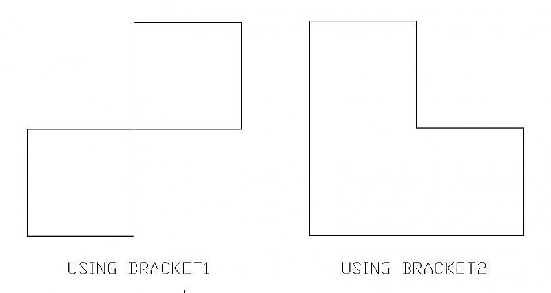

The Buzzard Posted June 6, 2010 Share Posted June 6, 2010 Hello Mr.Buzzard, I have wrote tow different Autolisp files that are dealing with our main issue which is (polar function) and here they are attached - downstairs - within this Message. So which one of them is the perfect Autolisp file that dealing with polar although, both of them are giving the same result withno mistakes. May I know your opinion about them please? with all my respects. Tharwat Hi Tharwat, I assume that both programs were to draw the same type bracket if supplied the same length information for A and B. It would seem to me one of them is a bit mixed up. My guess is that bracket2 is making the bracket correctly while bracket1 seem to make the bracket sort of twisted. You should recheck the calculations in bracket1.lsp (See image below.) One thing for certain is you are starting to get an understanding using for the polar calculations using the degree to radian function very good. One additional thing I noticed is the command call using language compatibility needs some adjustment. You have this in bracket2: (command "._pline" pt1 [color="Red"]"w"[/color] 0 "" pt2 pt3 pt4 pt5 pt6 [color="red"]"c"[/color]) It should look like this: (command "._pline" pt1 [color="red"]"_w"[/color] 0 "" pt2 pt3 pt4 pt5 pt6 [color="red"]"_c"[/color]) You need to use an underscore for the sub-commands as well. For a small routine you are getting idea. Keep up the good work. I was wondering if using the degree to radian was any easier for you. Quote Link to comment Share on other sites More sharing options...
The Buzzard Posted June 7, 2010 Share Posted June 7, 2010 Ok, I looked over both codes more thoroughly and here is what I found to be the problem. The length variables in bracket1 seem to be mixed up or in the wrong place and does not match bracket2. You had this in the calculations for bracket1: (setq P2 (polar P1 0 A)) (setq P3 (polar P2 (/ pi 2) B)) (setq P4 (polar P3 pi C)) (setq P5 (polar P4 (/ pi 2) C)) (setq P6 (polar P5 pi B)) You had this in the calculations for bracket2: (setq pt2 (polar pt1 (dtr 0) a)) (setq pt3 (polar pt2 (dtr 90) c)) (setq pt4 (polar pt3 (dtr 180) b)) (setq pt5 (polar pt4 (dtr 90) b)) (setq pt6 (polar pt5 (dtr 180) c)) So bracket1 should look like this: (setq P2 (polar P1 0 A)) (setq P3 (polar P2 (/ pi 2) C)) (setq P4 (polar P3 pi B)) (setq P5 (polar P4 (/ pi 2) B)) (setq P6 (polar P5 pi C)) Quote Link to comment Share on other sites More sharing options...
The Buzzard Posted June 7, 2010 Share Posted June 7, 2010 One final thing, In bracket2 you have the degrees to radian function within the middle of your main function. The DTR is a function in its own right so keep it separate. It makes it less confusing. Finally to answer your original question as to which method is better, I can only say its a matter of preference so you should know the answer to that. (Which method did you prefer?) You had this: (defun c:bracket2 (/ pt1 oldsnap oldortho newsnap newortho a b c pt2 pt3 pt4 pt5 pt6) (setq pt1 (getpoint"\n Specify lower corner point of Bracket: ")) (setq oldsnap (getvar "osmode")) (setq oldortho (getvar "orthomode")) (setq newsnap (setvar "osmode" 0)) (setq newortho (setvar "orthomode" 0)) [color="Red"] (defun DTR (ang)(* pi (/ ang 180.0)))[/color] (setq a (getdist"\nLength of A: ")) (setq b (getdist"\nLength of B:")) (setq c (- a b)) (setq pt2 (polar pt1 (dtr 0) a)) (setq pt3 (polar pt2 (dtr 90) c)) (setq pt4 (polar pt3 (dtr 180) b)) (setq pt5 (polar pt4 (dtr 90) b)) (setq pt6 (polar pt5 (dtr 180) c)) (command "._pline" pt1 "_w" 0 "" pt2 pt3 pt4 pt5 pt6 "_c") (setvar "osmode" oldsnap) (setvar "orthomode" oldortho) (princ "Made by Tharwat") (princ) ) Make it like this: (defun c:bracket2 (/ pt1 oldsnap oldortho newsnap newortho a b c pt2 pt3 pt4 pt5 pt6) (setq pt1 (getpoint"\n Specify lower corner point of Bracket: ")) (setq oldsnap (getvar "osmode")) (setq oldortho (getvar "orthomode")) (setq newsnap (setvar "osmode" 0)) (setq newortho (setvar "orthomode" 0)) (setq a (getdist"\nLength of A: ")) (setq b (getdist"\nLength of B:")) (setq c (- a b)) (setq pt2 (polar pt1 (dtr 0) a)) (setq pt3 (polar pt2 (dtr 90) c)) (setq pt4 (polar pt3 (dtr 180) b)) (setq pt5 (polar pt4 (dtr 90) b)) (setq pt6 (polar pt5 (dtr 180) c)) (command "._pline" pt1 "_w" 0 "" pt2 pt3 pt4 pt5 pt6 "_c") (setvar "osmode" oldsnap) (setvar "orthomode" oldortho) (princ "Made by Tharwat") (princ) ) [color="Red"](defun DTR (ang)(* pi (/ ang 180.0)))[/color] Quote Link to comment Share on other sites More sharing options...
Tharwat Posted June 7, 2010 Author Share Posted June 7, 2010 Hi Mr.Buzzard. I do appreciate your hard work on my modest Lisps, and that was more than enough to get the perfect idea of them. So by working and using different ways of sole functions, definitely that would show its hidden abilities clearer and welder which made me realize that using the (defun DTR (ang)(* pi (/ ang 180.0))) is really much easier and less confusion, due to direct input of the actual angle degree. And the way that you have changed codes in Bracket1 is really fascinating and smart, because it will never give the chance to Autocad to make that small tow boxes or going somewhere else if we entered A:less than B:. .... thats more than great. Many Thanks. Tharwat Quote Link to comment Share on other sites More sharing options...
The Buzzard Posted June 7, 2010 Share Posted June 7, 2010 Hi Mr.Buzzard. I do appreciate your hard work on my modest Lisps, and that was more than enough to get the perfect idea of them. So by working and using different ways of sole functions, definitely that would show its hidden abilities clearer and welder which made me realize that using the (defun DTR (ang)(* pi (/ ang 180.0))) is really much easier and less confusion, due to direct input of the actual angle degree. And the way that you have changed codes in Bracket1 is really fascinating and smart, because it will never give the chance to Autocad to make that small tow boxes or going somewhere else if we entered A:less than B:. .... thats more than great. Many Thanks. Tharwat Glad I could help, But I think you can see the value in it for yourself. Go with the method that you feel comfortable with. Quote Link to comment Share on other sites More sharing options...
