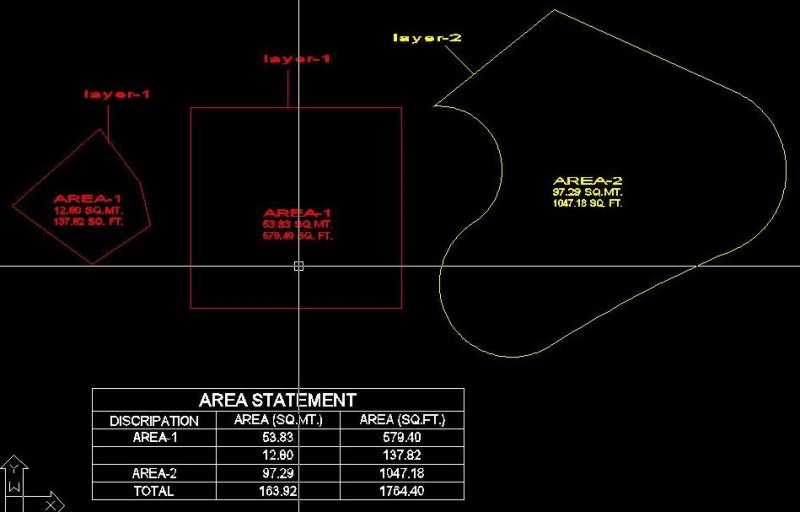

dear sir
nice program thx for sharing
it's possible
Pline area into table
  1. Select pline (various layer for example area-1, area-2, area-e etc. )
  2. Add area center of pline (area in sq.mt. & sq.ft.)
  3. And total in table (various layer for example area-1, area-2, area-e etc. )
dear sir,
i found some code in my comaany server
it's not english version
The one that you have selected is French Version by Mr. gile.
Chose the first web site to get the EngliSh One .
Regards
Tharwat
Regards
Tharwat
dear sir
gile code is working no prob it's very good
[ATTACH]21824[/ATTACH]
Do you have a specific task. If I have enough free time, try to write the program. At the present moment I have a program to capture the area of objects in the table
Command: AREATT (AREA to table)
This command allows you to insert into the specified table cell and the subsequent text field (FIELD), containing the value of the square of the selected object.
Depending on the choice of navigation options by rows or columns.
