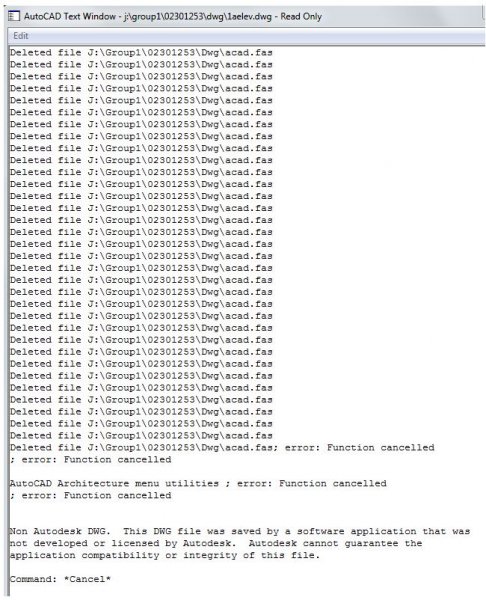

Ric Posted November 14, 2011 Posted November 14, 2011 Has anyone had any success with this solution? I have not. http://usa.autodesk.com/adsk/servlet/ps/dl/item?siteID=123112&id=13717811&linkID=9240617 What happens when I open an infected folder is the following loop until I hit Esc and cancel it. The virus remains. Any suggestions? Quote
ReMark Posted November 14, 2011 Posted November 14, 2011 Ric: What have you done so far to troubleshoot the problem? No sense repeating something you have already tried. Quote

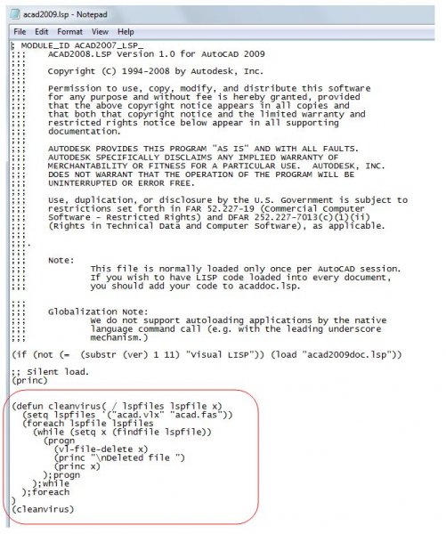

Ric Posted November 14, 2011 Posted November 14, 2011 I tried what was recommended but I replaced logo.gif with acad.fas since that is one we are having a problem with. See attached. I have an acad2009.lsp file in both C:\Program Files\AutoCAD 2009\Support and in C:\Users\ric\AppData\Roaming\Autodesk\ACD-A 2009\enu\support so I added the code to both files Quote
