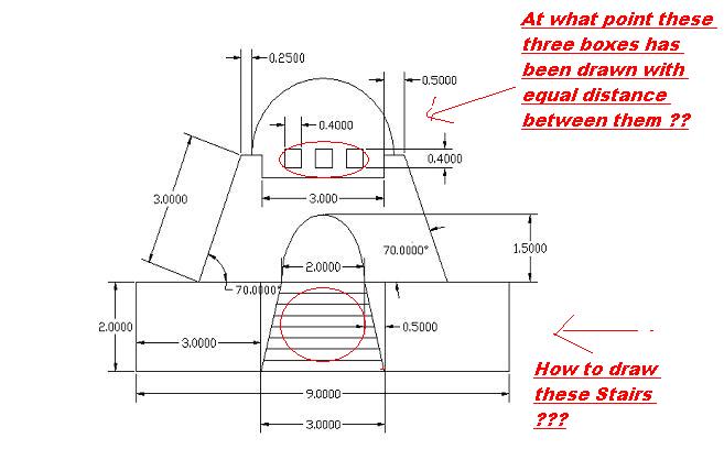

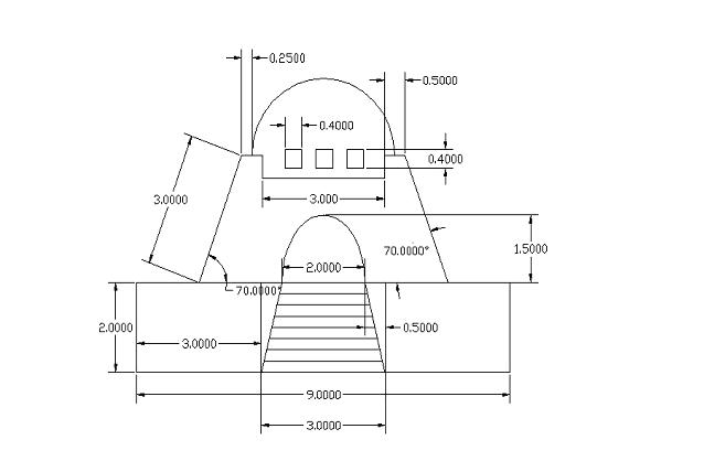

i want to draw this using only line tool ,arc and pline
First i set the area to 12x9 ,
and i've already drawn the rectangle at the bottom of this pic.
Command: pline
From point: 0,0
Current line-width is 0.0000
Arc/Close/Halfwidth/Length/Undo/Width/: @9
Arc/Close/Halfwidth/Length/Undo/Width/: @2
Arc/Close/Halfwidth/Length/Undo/Width/: c
as you can see the ladder is placed exactly in the middle,
can anyone tell me how can i draw ladder exactly in the middle using Commands ??
and on the left side of the picture, the line with 70degree angle having length 3.0 is drawn from which point ??? (i mean how to select that point from which i can draw this line )

not a complete answer but.....
you have the luxury of a symmetrical design, so you need only draw half of it, and MIRROR the whole thing at the end. this will also avoid the centre-line issue with the ladder, as it will now be at one side until the last step.
Looks straightforward to do with the 3 commands you suggest. Are you trying to draw this as a challenge? (eg only using the command line) I only ask as you ask 'can anyone tell me how can i draw ladder exactly in the middle using Commands ??'
Autocad has grips that assist with placing objects on the midpoint of a line which will help position the ladder in the centre and the 70 degree line also.
In command line, you would probably need to use co-ordinates so, the centre line of the ladder is 4.5 to the left. To draw the centre line, the command would be:

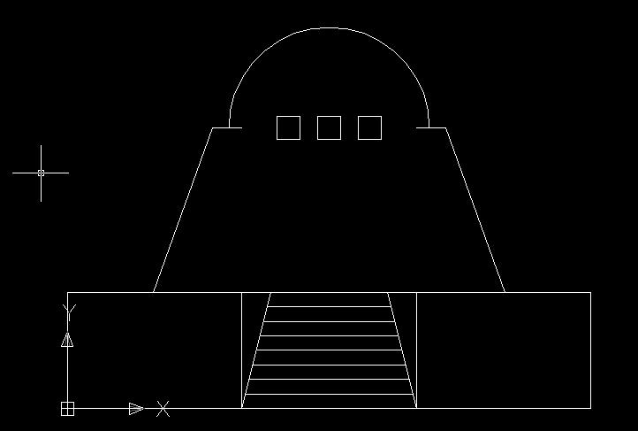

i've drawn rectangle and the two borders (left and right) of the wall and the two line of length 3 and angle 70degree :)
i've used rectangle to draw the bottom rectangle of 9x2,
and drawn the borders of the ladder using a polyline tool....but as you can see there are 8steps in ladder, how can i draw all of them using a single pline ??
and how to draw the curve which is above the ladder using arc ??
here is my work.

Just been trying it out with plines. Can get the stairs okay (with a bit of trig.... no stipulation of extra maths not being allowed!) and there are some dims missing / info that can be assumed. but it is possible.... Just needs more thought than 15.52 on a friday.....

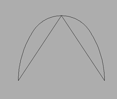

the curve above the stairs is not an ARC , am i right ?? then how it can be drawn ??
By drawing a Polyline with two straight lines. Then go into Pedit, define the tangents and Fit curve.

i have drawn this so far

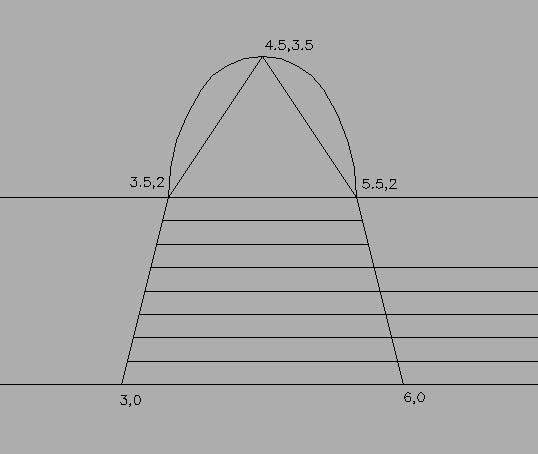

how to draw that curve above the stairs ?? and how to draw each step in the stair using Commands ?

I cannot understand your need to draw this using only Line, Arc and Pline. Are you allowed to use the Modify tools?
To get all the ends of the lines, you should go through the whole figure and calculate coordinates. I would not do it like that, but would construct the various elements.
As you so rightly point out, the shape above the stairs is not an Arc, and the only way to draw a non-arc polyline is to curve fit it after you have drawn it, or to use a spline (which you are not allowed to do). :cry:
yes modify tools are allowed and please give me a clue to draw the stairs and the curve at the TOP
The way I would draw the stairs is to draw the two side lines, and then offset the bottom line by 0.25 multiple times until you reached the top. Then trim using the sides.
The arch I would draw with a polyline to the coordinates shown. Then go into Pedit, Edit Vertex, and define the tangents at each lower point. Then Fit curve.

I worked out the angle of the two lines bounding the stairs (using trig) As you can get the length of all 3 lines making a triangle and one angle is 90 deg. I then worked out at each step, how much the vertical angled lines reduced the step width each time it ascended... If I get 5 mins ill do some steps with the maths noted on the side. Again with the 3 squares was more maths to work out the co-ordinates for the lines. The 3.0 line @70 degrees doesn't add up though. Some of the figures of the upper part aren't right....

The topmost half-circle can be drawn using the 2P option of the Circle command and picking the midpoint (Osnaps are allowed right?) of the two horizontal lines that are 0.5 in length.
I could also see the use (not necessarily the need as Eldon demonstrates above) of the Ellipse command to form the arch.

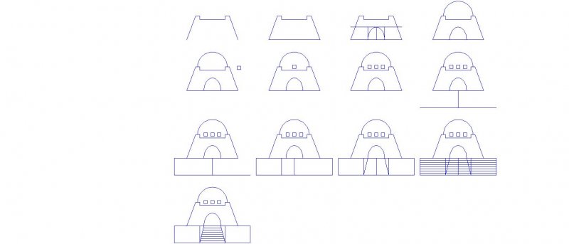

I got bored doing a deck design. Needed a break. :shock:
Great Drawn :)
Can i have the commands :(

you've said to use pline to draw arc above the stairs , but there is no option of tangents in pline

I did not use the Pline command to draw the arc (archway) above the stairs. I used the Ellipse command.
The stairs can be constructed using AutoCAD's Array command (pick the Rectangular option - 8 rows, 1 column with a row spacing of 0.25) OR you can use the Offset command and offset the bottom line, and each subsequent line, in turn, using an 0.25 offset distance.
So should i've to use Trim command after using array for stairs ?? because the stairs are crossing the left and right walls
