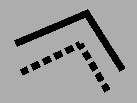

cadman6735 Posted September 1, 2010 Share Posted September 1, 2010 This one is driving me crazy There is a variable that will join the corners of a pline to look like a clean join as in a mitter join, with a sharp point as one would expect to see in a rectangle. But on some cases my plines join as if two line are meeting but don't clean up, as if there was a small triangle piece missing in the corner. I remember from earlier versions R12 and maybe up to pre 2000 that I had to set this variable. Since then I have not seen this occure so I have forgotten this variable. I have searched and search to find this variable, I guess I am not typing in the search correctly to find my answer. Does anyone here know this variable? Thanks Quote Link to comment Share on other sites More sharing options...
ReMark Posted September 1, 2010 Share Posted September 1, 2010 Are you using a non-continuous linetype? What is PLINEGEN set to? I know that line end styles and line join styles can be controlled at plot time by editing the plotstyle properties. Line end styles include: butt, square, round and diamond. Line join styles include: miter, bevel, round and diamond. Quote Link to comment Share on other sites More sharing options...
cadman6735 Posted September 1, 2010 Author Share Posted September 1, 2010 Hi ReMark Thanks for the reply, you almost got me excited... I am using a Pline and the only way I can explain is if you give a pline a width of 12" (for exaple, any width will show this) Now start your pline and make a zig zag but dont' exit the command. you can see the lines don't join , they look like end point on top of an end point. As soon as you hit enter or exit the command the lines clean up. Well I have found a few drawings that don't clean up, the ends remain as if they look while drawing the Pline. I remember this being an issue in school when first learning ACAD R12 and we had to either swith on a variable or exicute a command inside of pline itself, can't remember it is that long ago for me but this issue has raised its ugly head on a couple of drawings and I am stumped. Thanks Quote Link to comment Share on other sites More sharing options...

eldon Posted September 1, 2010 Share Posted September 1, 2010 But are you using a non-continuous linetype as Remark asked you? The way that AutoCAD draws a wide polyline is to clean up a corner afterwards when using a continuous linetype, but NOT when using a non-continuous (dashed) linetype. Quote Link to comment Share on other sites More sharing options...
cadman6735 Posted September 1, 2010 Author Share Posted September 1, 2010 Sorry, I miss understood I was thinking of an unjoined poly line not a solid continouse vs dashed Yes, I am using a continouse pline Quote Link to comment Share on other sites More sharing options...
cadman6735 Posted September 1, 2010 Author Share Posted September 1, 2010 but now that i am looking at your picture and you cleared up the question for me, I am now wondering if the lines used where dashed lines at the wrong ltscale making them look continouse. I didn't check this. But it was a title border line doing it and there is no reason why they would turn this dashed except by mistake. But I will still say I remember this being an issue way back when I first started to learn ACAD and there was a variable, I can't believe I am making this up. Quote Link to comment Share on other sites More sharing options...

cadman6735 Posted September 1, 2010 Author Share Posted September 1, 2010 ReMark ah, not to worry, this really is not an issue for me, just a bug up my butt trying to remember something that I might have imagined. (though I know I didn't) I hope someone, someday will be surfing by and go "oh, I know this one" and share the answer, till then at least I finaly posted the question. (the more I think about it the more I believe that it is from having two seperate polys and I have to join them to make them clean up as you stated in your second post). And you was right about the plotstyle, funny enough as I was having this discusion here on this site, I was helping another architect and he was having the same issue with his border sheet, this was due to the plot style being on butt not round. (and I woundn't have figured it out if I wasn't talking with you) Life is funny this way I guess I am crazy and imagining things, at least I can let this one go now. Thanks for letting me waist your time... :-) Quote Link to comment Share on other sites More sharing options...

Dana W Posted September 2, 2010 Share Posted September 2, 2010 No way. Try it. I couldn't, cuz my computer was under a plastic bag. Doing some ceiling patching. OK, so you can't fillet a pline to itself, open corner or otherwise. I don't make much use of the zero fillet. snaps work gooder faster. At any rate zero fillet leaves the corner apperance unchanged even when there are two lines or plines to fillet. I have rounded ends, which leave the wedgy gap thing on the outside corners. The fatter the line, (tested @ 0.083") the wider the blank wedge. The beveled ends don't gap, but then only at 90 deg. Quote Link to comment Share on other sites More sharing options...
cadman6735 Posted September 2, 2010 Author Share Posted September 2, 2010 I think the issue is with the plot style. I want to say I remeber keying it in becasue R12 is mostly key-in commands so I thought it was a variable as most varaible settings are keyed in, in the new versions today. So maybe setting up the plotter in R12 I confussed with setting up a variable. The only problem is I can't duplicate it to test it. I am chaning the endstyles but they clean up... Quote Link to comment Share on other sites More sharing options...

Dana W Posted September 3, 2010 Share Posted September 3, 2010 In the plot style table editor you can change the line end and join styles, but that is only for plotting. Don't think it affects the screen image. Come to think of it, this was already mentioned, sorta. Quote Link to comment Share on other sites More sharing options...
