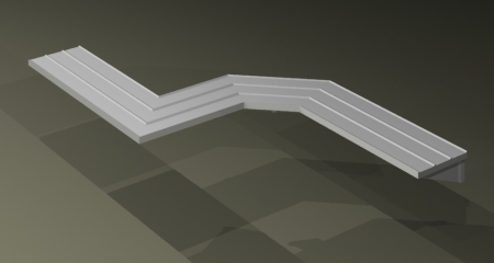

David Bethel Posted September 29, 2010 Share Posted September 29, 2010 To permanently disable the center line on mine, remark ( add ; to the beginning ) these lines like this: ;;;CENTER LINE ; (command "_.PLINE") ; (foreach p pl ; (command p)) ; (command "") To make it an option is not too dificult Speaking off, how the crap can y'all write so much code so quickly? Ugh... I'm always so envious of programmers that can "whip something up". - Tannar It's a little like being bi-lingual. It starts to become a more true language the more you mess with it. Listening to someone try to vocalize lisp can be very funny. (cdr) comes out 'cud-der' Try ( assoc ) Anyway, I already have similar programs that offset a center line with a profile for things like the tray shown here. So the guts were already made Quote Link to comment Share on other sites More sharing options...
