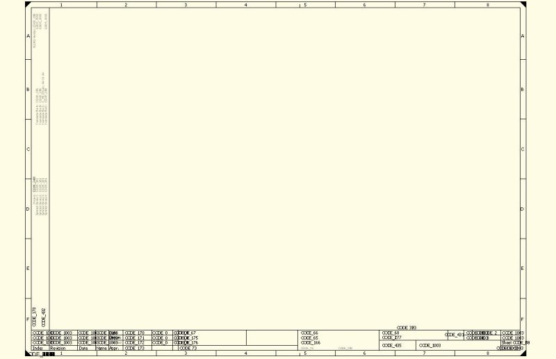

Just when I thought I had all the bases covered, they threw me a curve.
The titleblock has a multitude of attributes with the same tag, different values, evidently utilizing handles. Any suggestions?
Other than using the special explode feature. If all else fails, I'm not beyond using it. :P
That's ugly....
Is there any logic to the scenario? 1st tag is always the name, 2nd the date, 3rd the city etc?
