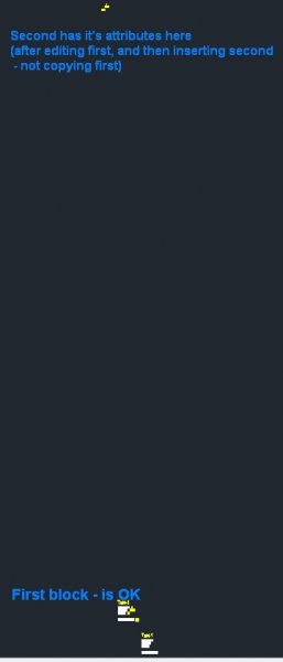

Hi, I used your solution in my block. But there is still some bug with it. In my block and in yours (FIELDS.DWG few post up). I have formula in attribute "T" with use of attributes "KAT" and "R". When I close block editor, those attributes (KAT, R) are placed somewhere in the space. After editing block and placing them in right spot and then closing editor, there are again at the same place (not near block).
This problem occurs when I edit values of your block and then insert new block. New block has dislocated attributes (but only from formula, "TYPE" is OK).
Unfortunately I can't use copy method because I had LISP that insert my block with two attributes exported from selected arc.
