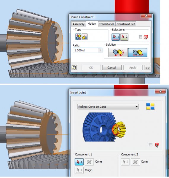

Hi,
I'm having trouble visualizing how to constrain two basic bevel gears to have them rotate in tandem. I'm using Inventor 2011 Pro and I'm not sure what the exact steps are.
Thanks!

I would use a Motion Constraint or a Cone-on-Cone Joint. You will need a surface body cone at the pitch diameter.
I would not use Contact Sets.
If you use the Design Accelerator the Motion Constraint will automatically be created.
Edit: I should have changed the Ratio in the Motion Constraint image to match the gear ratio. I think the Design Accelerator automatically adds the correct ratio.
