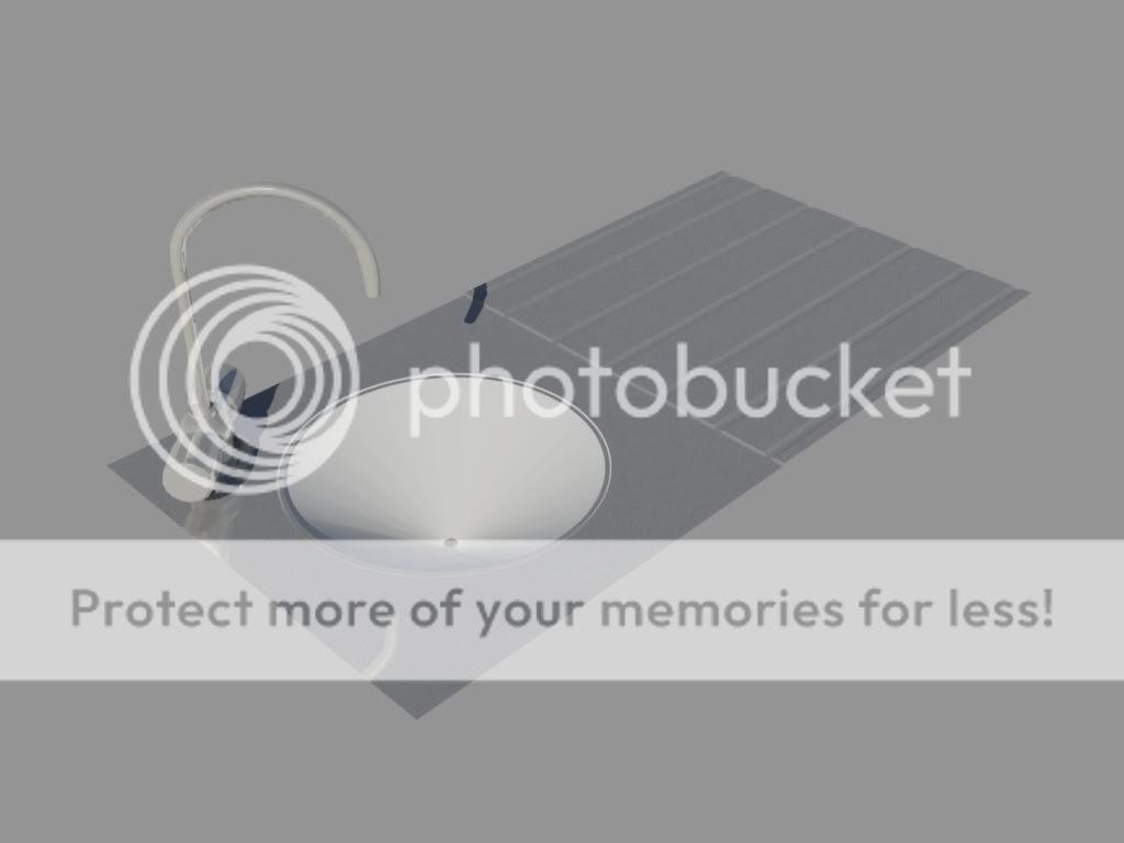

suresh0163 Posted June 8, 2012 Share Posted June 8, 2012 Quote Link to comment Share on other sites More sharing options...
ReMark Posted June 8, 2012 Share Posted June 8, 2012 Yep, that's one nice looking sink. Quote Link to comment Share on other sites More sharing options...
Cad64 Posted June 8, 2012 Share Posted June 8, 2012 Yep, that's one nice looking sink. And only 6 years after this thread began. I have to wonder though. Was this done in Inventor? too bad there's no information provided with the image. I guess we're just left on our own with this one. I do have one critique though. I see faceting in the sink bowl. That should be smooth. In Studio Max I would put a Smooth modifier, or a Turbosmooth, on the bowl. I don't know how it works in Inventor though. Quote Link to comment Share on other sites More sharing options...
ReMark Posted June 8, 2012 Share Posted June 8, 2012 Maybe he was going for the coveted "Oldest Revived Thread" award? Quote Link to comment Share on other sites More sharing options...
JD Mather Posted June 8, 2012 Share Posted June 8, 2012 I don't know how it works in Inventor though. Looks like garbage to me. Attach the assembly here. Quote Link to comment Share on other sites More sharing options...
