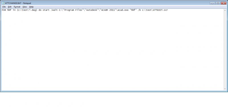

JPlanera Posted January 12, 2011 Share Posted January 12, 2011 ok.... onw thing i dont see clarified is this... the entire .bat file needs to be ONE line in notepad. if it sees a line break in there it will gag on it. If you still have trouble with it. Move all the drawings to a temp folder that is simple. then change your code to this exactly (Z:\TEST\*.dwg) instead of that long string... Quote Link to comment Share on other sites More sharing options...
JPlanera Posted January 12, 2011 Share Posted January 12, 2011 this worked for me on my system Quote Link to comment Share on other sites More sharing options...
YZ Posted January 12, 2011 Author Share Posted January 12, 2011 ok.... onw thing i dont see clarified is this... the entire .bat file needs to be ONE line in notepad. if it sees a line break in there it will gag on it. If you still have trouble with it. Move all the drawings to a temp folder that is simple. then change your code to this exactly (Z:\TEST\*.dwg) instead of that long string... Yes, the .bat file is all on one single line. I have just made it work on the (Z:\TEST\*.dwg). Thank you SO much JPlanera. I will try one more time to debug my original .bat, otherwise I will move the folders to a simpler path. Quote Link to comment Share on other sites More sharing options...
JPlanera Posted January 12, 2011 Share Posted January 12, 2011 What's odd, is that i created a path on my system that was exactly this (C:\"2010"\"2010059 A"\"_SUBURB NAME"\"_PROPERTY PLANS"\"STREET TEST"\"*.dwg") and it worked fine.... I'm glad you got it going. I'm sure all this work is still better than one by one file editing! And you can use this same method for any script file so once you get it solid, you are set!! Post back your solution if you figure out your bug. I'm curious now! Good luck:) Quote Link to comment Share on other sites More sharing options...
