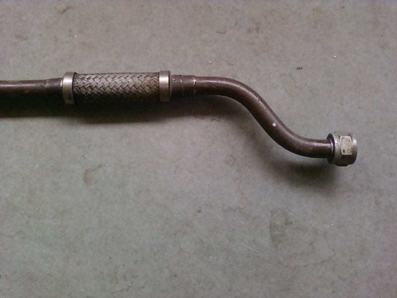

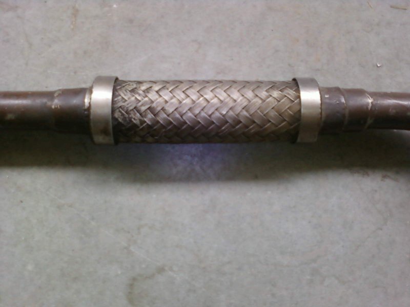

@ReMark : i work in metric system.. actually the pipe is abt 600 mm long and belongs to fuel booster pump in a transport aircraft..it has op temp of abt 200+ deg cel..and has a steel mesh with adapter in the centre (i.e. welded) and at the ends has hex nut and a nipple... finally it is bent in all 3 axis..
thats why, i am thinking of posting a jpeg..which will help..

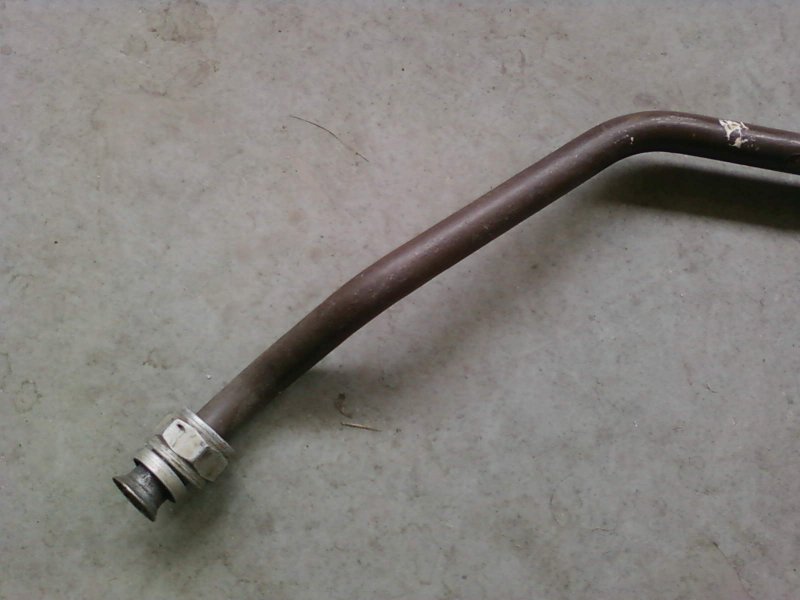

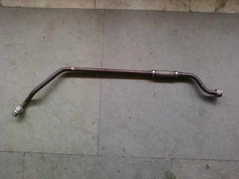

due to site unavilability i could not post the photos... here r the pipes i would like to draw in 2d... pl suggest ways for drawing.. thiPhoto0917.jpg

actually i am ease at creating steel nut, nipple, steel braided hose and all fittings in between.. but my quality staff is asking me to represent the bends (like angles wrt x, y and z axis).. initially we were making 2 staright lines to represent pipe line.. with a quotation of "bend as per original sample:".. but since quality staff requires more, we dont know how to represent them.. i want only ideas or some sample pipe drawings.. not LISPs.. thanks...
It appears as though a majority of the pipe could be detailed using a single plan view. The small remaining portion could perhaps be detailed using a plan view and at least one side view.
Do you have any dimensions or angles to work with that you could post here?
One other option is to construct it in 3D then use one of three methods to extract the 2D views from the 3D object.
abc_123,
Your pics are of tube NOT pipe.
If I had to draw this for a fitter to make, I would do it single line isometric. That is the easiest way to show and dimension the rolling offsets.

@ReMark : its abt 410 mm lengeth and has variying angles on all 3 axis.. abt 15 to 20 deg..
@kramerO : that pipe.lsp i just loaded for trial purpose.. not for this.. but do i have to put all the contents in the resp. folder ?..i think ur method of rep single line seems ok for me..
@ReMark : any comments on single line isometric ?
