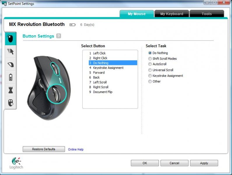

Kampfzentrum Posted February 9, 2011 Posted February 9, 2011 Hey all, I'm hoping that things are pretty friendly around here, as I will be here for awhile. My company just switched over to AutoCAD for 2D plant layouts whereas normally I'm designing tool fixtures in SolidWorks. I find AutoCAD incredibly rigorous and overwhelming when it comes to the interface and customization. So most of my questions will be regarding that. I have used AutoCAD when I went to school for drafting, but since then much has changed. OK, simple question at first, I have a Logitech MX Revolution and am trying to map commands to the mouse. For instance, when using a standard mouse, holding down the middle button will enable you to pan. I want this function - and others - out of my Revolution mouse. Right now, if I hit the middle button an pointer appears that looks like 2 outward pointing triangles on the obliques of a circle; when this appears I am able to move side-to-side, but not up and down - eventually my drawing disappears and I am forced to "undo". Can anyone help me? Quote

nestly Posted February 9, 2011 Posted February 9, 2011 I have a Logitech M705, (8 buttons if you count the tilt wheel) and I just use advanced setting in the Logitech software (SetPoint) to assign the buttons whatever function I want it to perform in AutoCAD. Specifically, the middle mouse button should be typically be assigned to "Middle Click" or "Middle Button" for panning in AutoCAD, Quote
Kampfzentrum Posted February 11, 2011 Author Posted February 11, 2011 Well, I'm in the CUI, I am looking at Pan (Realtime) and I cannot find a way to map a mouse button to this command. Also, I went into the SetPoint and tried to map but say, for instance, I want the middle button to Pan, I would have to map a "P" and an "Enter" - just too much. If there was a shortcut key for Pan, I'd be in. Is it me, or is AutoCAD just a bit unuser friendly? I mean, is AutoDesk a German company? Because they sure over complicate the sh*t out of this. SolidWorks just seems so much easier and streamlined compared to AutoCAD. No offense to the hardcore AutoDesk users, just frustrated with this program. Quote

nestly Posted February 11, 2011 Posted February 11, 2011 What is the action/task assigned to the middle button in SetPoint? If it's "Middle Button" or "Middle Click" then rolling the wheel should zoom in and out, and depressing wheel should pan. When you depress the Wheel, your cursor should turn into a "Hand" Quote

nestly Posted February 11, 2011 Posted February 11, 2011 Oh... no "middle click" by default? Those Logitech guys need to be thumped on the head. Try the Option for "Other" and then see if "Middle Button" or "Generic Button" is available from the drop down list. Quote

Kampfzentrum Posted February 11, 2011 Author Posted February 11, 2011 OK, "Other" brings up a pre-configured menu of Cut, Paste, etc. Nothing for AutoCAD. As for the drag and drop deal, here's my issue. The CUI has a listing of 10 (I think) different mouse buttons and they all have different assignments, however, AutoCAD is not recognizing any of the other buttons on this mouse. So something between AutoCAD and the mouse software is not communicating. I think that I'll have to go to the Logitech to get this thing licked. Quote
Kampfzentrum Posted February 11, 2011 Author Posted February 11, 2011 I f*ckin' got it! It was the damn Logitech software! If I turn it off it pans just fine. Blasted stuff! Blarg! Quote
nestly Posted February 11, 2011 Posted February 11, 2011 If you turn of SetPoint, I'm not sure you'll be able to customize your buttons. The only problem I have with SetPoint is it causes the borders of the palettes to display improperly. What version of SetPoint are you using? Here's the options I have for "Other" http://screencast.com/t/n3A3KVH9bM0 Quote

Kampfzentrum Posted February 11, 2011 Author Posted February 11, 2011 AHHH!!! Nestly! You're a genius! Totally works now! And thanks for that descriptive video. Now I really got it. I never thought of going to that, I figured those functions were all Windows operations. OK, after reviewing this thread, I realized that I did something wrong. Above when I said I could not get .dwf files to associate with AutoCAD, I meant .DWG. Yeah, for some reason, I cannot open up a .dwg file with a double-click, I have to open it through the "Open" command. I have tried associating it in Windows by setting the default program, but no luck. Quote
