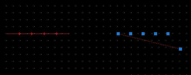

idhoe Posted February 22, 2011 Author Posted February 22, 2011 Hi Everyone, thanks a lot for the response. I am attaching a picture showing what I want to do. In the left side of the picture, a line is divided in to 5 parts which means autocad will insert 4 points on the line. In the right side of the figure, I select the line and all points then move an end of the line to a new position while another end is fixed. You can see that the points do not move with line. I am wondering if these points also move with the line. After moving the line, the position of points should always divide equally the line. qselect, and group could only help me selecting the points and line while I can not use block because I need to export the information (coordinate) of the points in the new position while converting to block will remove this information. I need to do this many times so that divide it again will be very laborious for me. any help will be very much appreciated Quote
ReMark Posted February 22, 2011 Posted February 22, 2011 OK, so we aren't moving the line itself we're moving one endpoint of the line. Actually it's more like rotating the line about a fixed endpoint. You're looking for some kind of rubberband like effect where the points on the line would remain equidistant from each other whether the line is made longer or shorter. Quote
eldon Posted February 22, 2011 Posted February 22, 2011 I need to do this many times so that divide it again will be very laborious for me. Perhaps you could move the line BEFORE you did the Divide, then you would only have to do it once. Quote

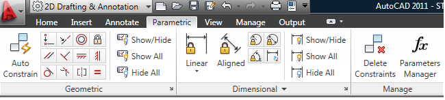

qball Posted February 22, 2011 Posted February 22, 2011 I made this using aligned dimensional constraints in block editor. But it only stretches linearlarily (yes I absolutely made that word up). You have to rotate it manually. Maybe someone else can add to it. edit: linearly is correct, I was close linesss.dwg Quote
SLW210 Posted February 22, 2011 Posted February 22, 2011 I made this using aligned dimensional constraints in block editor. But it only stretches linearlarily (yes I absolutely made that word up). You have to rotate it manually. Maybe someone else can add to it. edit: linearly is correct, I was close Something like that is what I was thinking, I would use = constraint between the the points (you will need to make seperate lines between the points and/or replace the points with small circles) and add a stretch and/or rotation parameter. If I only knew the intended purpose, I could do one out in a couple minutes. Quote
